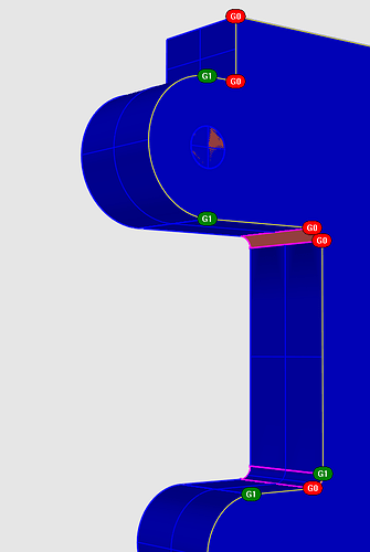

The problems you see here can of course be fixed using various commands, but it may be better to understand where the source is and just rebuild the part with one single Extrusion. First of, the badly meshed surfaces are caused by some heavy reparameterisation values like: (1.52508e+14 <= U <= 1.52508e+14) how did you created them ?
You might check out the originating curve highlighted in below pic, why are your fillets not G1 but sometimes G0 ?
Usually, if your curve is clean, you can just extrude it to a solid to built this part. To make sure that the linear surfaces are seperated from the circular surfaces, run _CreaseSplitting and set it to _SplitAlongCreases=Yes. I would sugeest you use this as your default setting and leave it that way.

Well, the profile I used was checked and redrawn to have simple low point arcs. Everything was projected to the cplane for good measure and then the planar tool was used. Afterwards I moved the surface to where it needed to be and then extruded it.[quote=“clement, post:10, topic:31325”]

That’s my standard MO in these matters and I seldom run into problems.[quote=“clement, post:10, topic:31325”]
[/quote]
I really don’t know why such is happening. I’m using the fillet curves command for these corners. Perhaps I’m overlooking a setting. I did catch a discrepency after redrawing, joining and checking the points afterwards. A clean arc was changed to a multipoint version because one of the two curve ends being attached was not exactly verticle to the other.
The thing is, when I see clean control point counts, I’ve no suspicion the curves are not quite right.

That does not seem to be the experience of most users. My suggestion is to not just find problems and fix them, but rather determine what actions caused the problem.
Try try tracking the source of the problem. I´ve duplicated the border of one of the planar side surfaces and found it is closed, but not planar.
Curve_WTF2.3dm (219.5 KB)
EDIT: Forgot to put the fixed curve in, compare the two 0.5 fillets: Curve_Fixed.3dm (218.5 KB)
c.
Take this 0.5 fillet for example:
The single controlpoint is ok, but note it’s position. It should be located at the intersection of both tangents from the lines. If not, you might just delete it and create a new fillet.
btw. you might use _GCon as well to measure the angle between both lines involved into this fillet. I get a value of 89.986 instead of 90.
