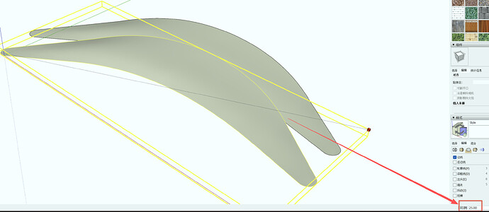

Hey, guys!
I defined a block in Rhino and then exported it to SU. It seems fine at first glance, but actually the block in SU has been applied a 25x scale. When I reset the scale, it becomes 25 times the original. I didn’t perform any scaling operation on the block in Rhino. Why is this happening, and is there a way to fix it?
block scale problem.skp (287.2 KB)
Could the scale possibly be exactly 25.4 ? ie: 1 inch = 25.4 mm.
yep, but I chose the mm template in rhino, why convert to inch when export?? mm=> inch => mm?

Why do you think Rhino is “converting to inch” upon export rather than SU doing it upon import?
Hey,Jeremy,When you right-click on the block in SU and choose to reset the block scale, is it correct?
Yes, it could happen during import, or it could happen during export;, I am not sure.
If you right click & choose Reset Scale, Su will change a component that was imported and initially appeared correctly at an original size of 10 mm from 10 mm to 10 inches.
To stop Su from doing that, select the component, right click and choose Scale Definition before doing anything else. Having done that, Reset Scale will correctly reset the component to the imported size of 10mm whenever you use it.

When Opened in SketchUp, the 10mm object in the Saved file rescales to 254mm on running Reset Scale.
When Imported into a file in Sketchup, the 10mm object from the Exported file also rescales to 254mm on running Reset Scale.
In both cases, running Scale Definition immediately on the 10mm object sets that as the base size and Reset Scale after any subsequent resizing will return the objects to 10mm.
Choice of units in SketchUp has no bearing on this.

My suspicion is that there may well be data in the skp file that records the scale baseline size distinct from the current size of the component and Rhino should set that to the same value as the current size (or perhaps the unscaled size of a block definition if the imported instance was scaled in Rhino) but that is either not being set or is set with the wrong, or no, units.
I guess the answer might be found by creating an equivalent component part in Sketchup and reverse engineering the skp file differences.

Yes, scale definition can fix it, but it is not the most direct solution because you need one by one to fix it. I think it may be a Su bug if you export the block as 3ds file, it works well.
I asked Gpt and it said that It may be because SketchUp’s original unit system is based on the imperial system.
I do another test, create a block in rhino use the inch template, and export to su, it works well. So I think the sketchUp’s native unit system maybe based on the imperial system, and the bug happenned during import
This issue with blocks was logged earlier as https://mcneel.myjetbrains.com/issue/RH-74216
