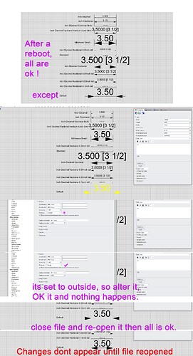

So the rules for inside/outside arrows are different in 8 then they are in 5 at those marginal spacings. Essentially due to how many complaints we used to get.
Inside/out arrows can be changed on the Dimension instance or in the dimensions style if the arrows need to be forced inside or outside.
So that should give enough flexibility to get what you need.

On the arrow settings I had tried fit arows inside and also outisde and nothing happened !
I will try again but thats what happened…NOTHING.
ok tried again, AND NOTHING happens. :worried:

Large meshes with textures could really make a big difference. So, there is a tradeoff at some point. As Rhino has gotten better with larger models this difference has only become greater with Rhino 6, 7 and 8.
The arrow issue is odd that the setting is not working. Changing it on the dimension instance is the best way to force it.

The inheritance of the setting from Dimension style thru to Instance I need to check out.
I expect if you set it directly on the dimension it works. Although, I think both methods should work.
@scottd
I opened what hadn’t worked and its worked, except one, so alter that and nothing happens, close rhino and reboot then it happens.
Obviously a fault in V8.
That just leaves the text gap thing that diesnt honoir the value used.
so two fixes needed.

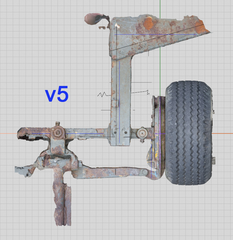

Half a success perhaps.
Steve
The mesh mapping is something that is different. Let’s start and exploration for that. Do you have and example file or two you can send. I will take a look. I may also split this thread here so we can deal with the texture stuff on a different thread. I can look at this today or tomorrow.
I have a thread on this and have sent the files to tech@Mcneel.com using pcloud at 1Mb per sec :frowning:
V8 file import V5 file loses OBJ texture mapping when File open works - #4 by Steve1
the layer has the obj name on it, its the bottom most one that failed (no rulers v2)
Cheers
