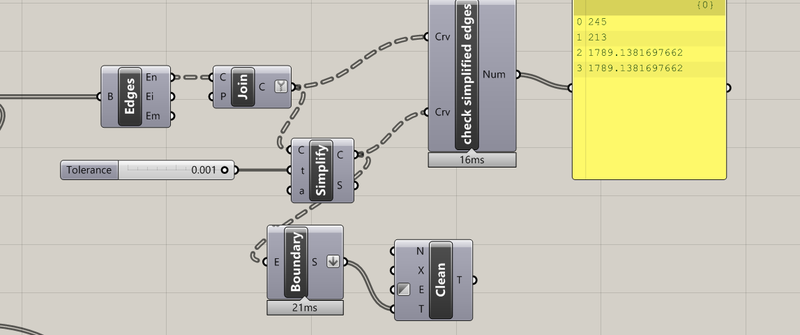

Way I am doing it is by pushing the geometry into a family using rhino inside, getting the type name and then extract the faces from that family:
I also clean up and check the faces first by running it through this, also making sure that my edge poly-lines have only corner control points:
and each time I update the geo, just delete the type, and push it back in:
Thanks for sharing the workflow! :pray: Good point with simplifying edges and checks! I have the simillar workflow right now, I’m Creating the Mass Family and getting the faces of that Family to host the walls. The Japhy’s solution with computing references got it to work for me.
The only thing I’m not sure atm is the binding. Because if we delete the existing type from the family and recreate the geometry inside Mass family it seems that all the created Walls by Face will loose their hosts since the new geometry for the mass was created as a new element(?)… Ideally I aim having walls updated to changing mass and not to be deleted and recreated using “Walls by Face” method again. :slightly_smiling_face:
