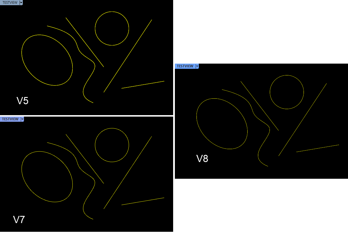

V8 line quality still is ragged not smooth as V5
Hi, V8

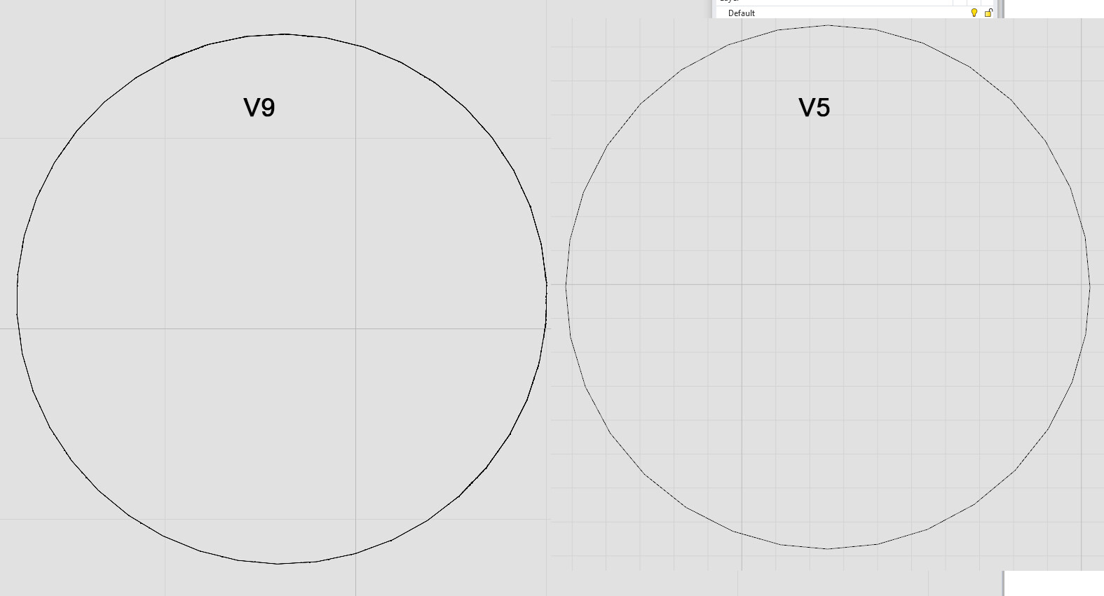

circle is not as such all way round but has rough areas, its making me think lines dont reach it.
In V5 a circle was a CAD item perfect all round.
I have lines coing up to it yet the mess denies me seeing if I have it as I wish.
Also an arc was deceiving me, until I opened it in V5 and then could see what I needed to see.
view this in photoshop ‘ACTUAL PIXELS’ SETTING’ as one needs to see how they ACTUALLY appear.
(cant find the arc yet did a screenshot..damn !)
I had hoped V8 had solved this, as it was main reason I went back to V5 from V7.
This is CAD after all.
Steve

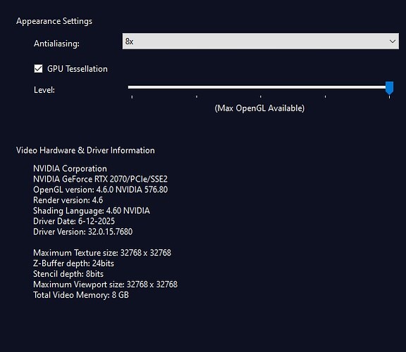

This is what my default V8 looks like on my 4K screen at 150% display scaling:
(maybe with a lighter background to match yours)
NVidia RTX 4070 12Gb - 4x AA
Hi Steve -
As mentioned before, we have Rhino 8 curve drawing on the list as RH-78744 Display: Curve drawing quality
Gijs I seem to recall had found that altering gamma solved it.
I did that in V7 and it did, but the grid lines were then awful, I altered the colours of the grids and sorted that, but then when I went to ghosted view they were bad again, each viewmode was awful, so I went back to V5 …and stayed there ! someone said resolved somewhat but not perfect in V8, so then I get V8.
please note this in that set of comments the link takes me to.
Having just used V8 fresh from V5 its a shock to the system.
I was also told the new graphics cards are not as good at curves and lines anti aliasing.
however my new card a Geforce RTX 3070 is looking fine on V5, and poor on V8 , so its not the card !

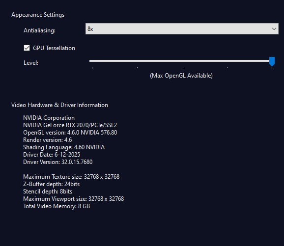

i have these settings for rhino 8 if it helps, im guessing its AA affecting lines, its no v5 but to me its good enough
in v8

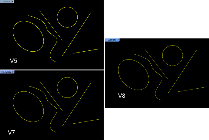

all images that are screen grabs in rhino, to be viewed in pshop as top menu>View 100% or enter that in the % box bott left of the image.
V5 is a thin pure line, and see why that is, no steppy nature, AA far better.
I am running a Nvidia GeForce 3070 current card, so no saying its the fault of new cards, as V5 is being run on it as well.
In V7 Gijs said alter gamma solved it, it did but the grids were awful, a tail chase developed to solve the knock on effect, and result was awful
lines steppy, rough, projects to mesh have ants on fishing line look, despite it being said its been solved. V5 can do it.
If I have line thickness set for drawn lines different in V9, let me know, I did ask before doing this, but both layer palettes are set to default. and anyway why make default worse ?
Steve
I knew i wasn’t going more nuts than I already am there is something very different with v5 and V8 quality lines by default
Unfortunately it does not get better than those settings for V8 if I missed something here I don’t know but works for me good enough
What monitor are you running? Maybe a higher resolution one can make it look better
Steve is showing super dense polylines in his images and that is what we are trying to figure out.
@Steve1 what’s the size and resolution of the monitor your are evaluating this on?

the little enlargement showing the steps versus the v5 smooth transitions is the cause.
and the ants , still to solve, a separate issue perhaps. so 8.22 if its in this WIP hasnt solved anything.
Steve
There is a hidden command that let’s you alter the wireframe thickness in Rhino. Note that it controls both, surface wires and curves in Rhino 7 (which is a good thing), but fails to control the line thickness in Rhino 8 (super wrong decision). At lest that was the case when I tested the command in Rhino 8 Evaluation.
Interesting i am using the same res 1920x1200 on an old Fujitsu screen
V8 had stuff changed under the hood also
“Aliasing is more noticeable at lower resolutions or when viewing the image up close.”
I got this answer from a quick search and what helvetosaur showed from his 4K screen it could improve the situation but not solve it with higher res monitors
If I understand this right from the RH - 78744 list the line quality has been regressing since v7?
Now in Pshop zoom in the top of the circle the same amount for V5 V7 V8 and do a screen grab (printScrn button to right of F12) and paste into new file and cut out the same small area and post, here. as I did for my comparison.
I bet there are no visible hard opaque few pixel long steps..
repeat for the lines if you wish.
It is purely down to the anti aliasing, nothing else.

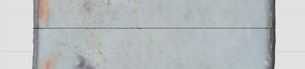

I will be placing sections through an obj mesh, projecting a straight line to mesh, and dont want ants on the line, as was happening in V8, and V9. but not in V5.
Where are we on that now, as many moons have passed by now.
update…launch V8, circle not much better,
section line , ants still along it.

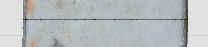

Just experienced this, a shallow line V8 thick and thin etc.
and same line in V5.
I really had hoped that 7 months later we were better for this now.
and marked
and line projected to mesh, ants along the line,

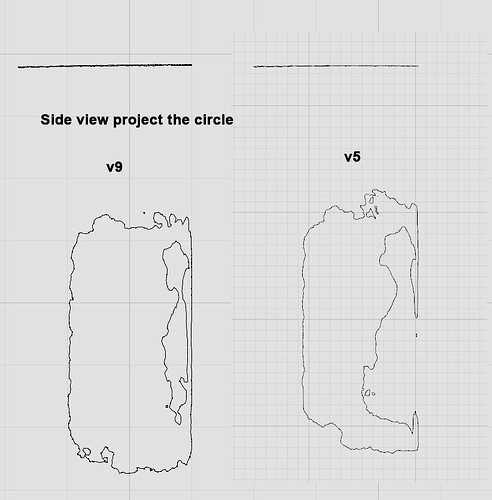

V5 v V8 line project to mesh
I ASK THE BIG QUESTION, IS IT IMPOSSIBLE TO FIX THIS, AND WHAT HAPPENED TO CAUSE IT ?
Come on McNeel , how long does it take , its basic fundamental stuff. its how we view lines.
