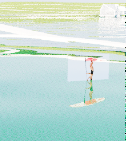

V-Ray for Rhino shows full PNG transparency on CPU, but not on GPU
Hello all, I’m trying to render this image, and it’s only fully transparent when using the CPU, which I understand is much weaker. What can I do?
Thanks a lot:)
ignore that the png is upside-down

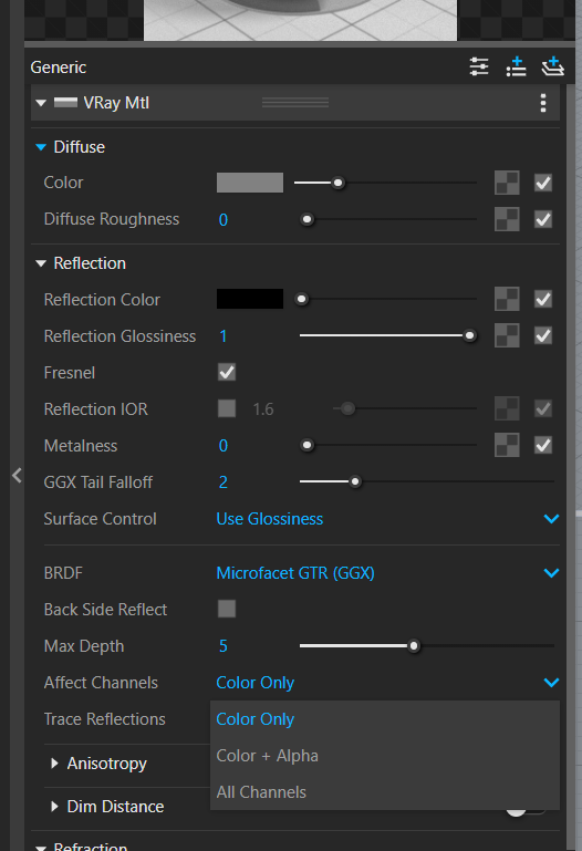

Your background isn’t transparent?

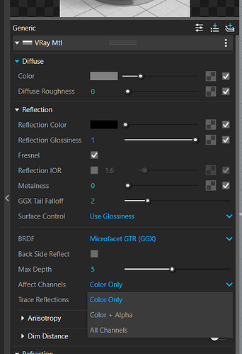

Or did you mean you want to get a transparency in reflection and refraction? If this is the case than try an other “affect channels” mode. First enable advanced settings per slider icon on the top.
