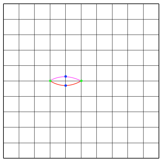

I am currently trying to better acquaint myself with coding with meshes by recreating the effects shown below:
The logic basically creates a minimum spanning tree graph based off of a mesh and creates cuts along the edges where the graph does not traverse an edge. This is very similar to what I imagine the Ivy plugin has under the hood. I am more interested in learning myself on how to implement this myself, so I decided to give it a go using Plankton.
I have managed to implement the creation of the tree graph (in blue) and have isolated the cut lines (in red) in C#.
MeshGraph
The trouble I am having is figuring out the best way to “unweld” the edges of the plankton mesh. As opposed to other discussions on mesh clustering/stripping that I have found, my problem is unique because the mesh remains one piece with many unwelded edges as opposed to many separate mesh pieces.
https://discourse.mcneel.com/t/mesh-clustering/63943/15
https://discourse.mcneel.com/t/mesh-pattern-segmentation-for-fabrication/84412/11
To my knowledge Plankton’s data structure only lets you split edges to add vertices in the middle, so I have tried to translate it back to a rhino mesh to split it with no success. I think it has to do with the fact that the un-weld edge function has to happen multiple times around particular vertices and the face ordering gets messed up. The other alternative would be to iteratively construct a new mesh as the graph is being made, but I am also running into mesh face structure ordering problems.
Does anyone have any ideas on how best to achieve this? I am not much of a coder but I imagine the most elegant way would be to have a property stored in a custom mesh class which allows you to do this but I am stuck and curious how others would handle this.

For regular Rhino mesh you can use UnweldEdge with a list of indices like this:
PlanktonMeshUnroll_unweld.gh (14.6 KB)
(it’s easier to build the list first then unweld them all at once, so you don’t have to worry about the edge indexing changing as you go)
Plankton doesn’t have welded and unwelded vertices. What you’d need there would be something to cut open an internal edge to make it into a boundary. Boundary half-edges in Plankton have their adjacentFace set as -1.
(Edge Splitting in Plankton is a different thing, and not relevant here)
So you’d want something that takes a linked pair of half-edges that make one internal edge, and makes a new half-edge to pair with each of them, setting the adjacent face of these new half-edges to -1.
For one isolated edge with both ends internal vertices it wouldn’t need to add any new verts, but when cutting open an edge with one end a naked vertex, it would need to create a new vertex.
I’ll look at adding a function for this. It could also be helpful to have something that takes a list of edges to cut, to avoid the issue of indexes changing as you go.
However, I think the easier way would be to make a new mesh, keeping the original unaltered. Using your list of the ‘toCut’ edges you want to open up, you could start from an arbitrary face, add it to the new mesh and get all its adjacent faces (in the original mesh) except for those which are the other side of one of your ‘toCut’ edges. Then keep iterating this until all the faces have been added.
