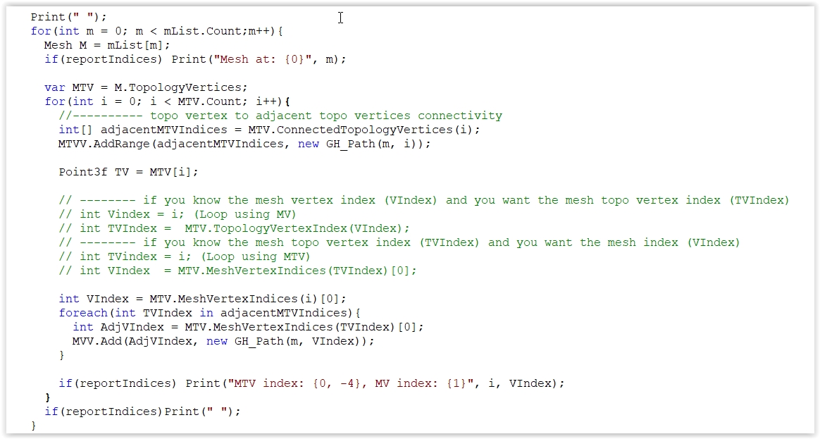

BTW: MTV indexing is NOT the same as MV indexing (I hate meshes):
This means that another way to spot the unwelded stuff is to test this (i acc MTV indexing) that yields vertex indices FROM vertrex topo indices:
int VIndices = MTV.MeshVertexIndices(i);
if(VIndices.Length >1) … blah, blah

  1. A mesh has vertices that you can see … but are separated in 2 freaky classes: the topology vertices (in fact what you see) AND the vertices.
  2. Vertices MAY are more than topo vertices (notably in unwelded edges cases and/or in bananas meshes).
  3. The check for welded unvelded refers to check the 2 Lists of adjacent faces indices BUT not the topo vertices indices (LOL) : we are talking vertices indices (LOL2). If these Lists have nothing in common … then the edge is unwelded (LOL3).
  4. In order to add oil in the fire (and create more confusion/panic) I have added a “help” C# that lists for you the face topo vertices indices VS the face vertices indices per pair of adjacent faces in clothed edges [ for naked : why bother talking?]. As you can see the numbers differ.
Maybe this image (reds are topo vertices indices) explains the freaky situation where 2 faces (the adjacent to a given edge [E666] according the EF connectivity) MAY yield 2 vertex indices Lists (blue) that have nothing in common (i.e. their intersection is an empty List) : meaning that E666 is unwelded (LOL*LOL):
