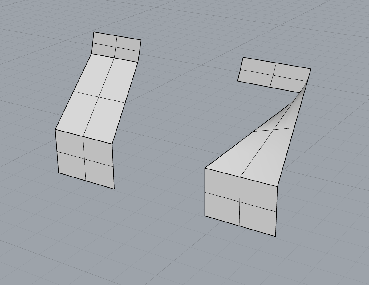

When I have history turned on in a situation like the attached, any trim I do of the surface seems to make the curve (which has the history) decide to attach itself to a different edge. Could this be fixed? It’s a behaviour that makes history much less useful for me.
Why can’t history be maintained if I’m not trimming the edge that the curve has history with? I’d either want it to maintain history & curve to continue to be linked to that edge, or just break history. It certainly doesn’t help for Rhino to just pick a new seemingly random edge to match to, which alway seems to be any edge other than the one that it was matched to before. Does that make sense?

Yeah, but the bigger problem for me is the random reassignment of history to other edges of a surface, like my example. Maybe I’ll post a whole bunch of examples when I get a chance.
I don’t think our History infrastructure supports this. When the curve was created the Match command, stores a CRhinoHistoryRecord together with the curve. The record contains a reference to the brep object, and a component i.e., Edge-7.
When the brep gets replaced in the Trim command
the ReplayHistory function of Match is called to generate a new curve. However only the brep reference has changed. ReplayHistory will inquire about Edge-7 of the new brep, even though the edges got renumbered in the Trim operation.
So the history mechanism needs a way to communicate with the Trim command about updating the information in the history record.
Even just breaking history on everything modified by Trim would need support from the History mechanism.
