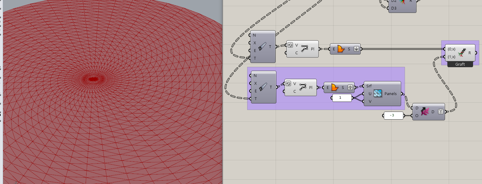

I am currently working on a round roof structure, I use a radial grid for it. I am now able to triangulate one cell of the structure but I can’t repeat the operation to the entire grid!! I have tried to use Series and Repeat Data but I couldn’t figure it out. Could you please give me some tips or instruct me how to do it, please?

Like this?
radialroof_re.gh (17.3 KB)
Or you could use “Lunchbox” plugin or Mesh triangulation.
radialroof_rev2.gh (21.0 KB)
