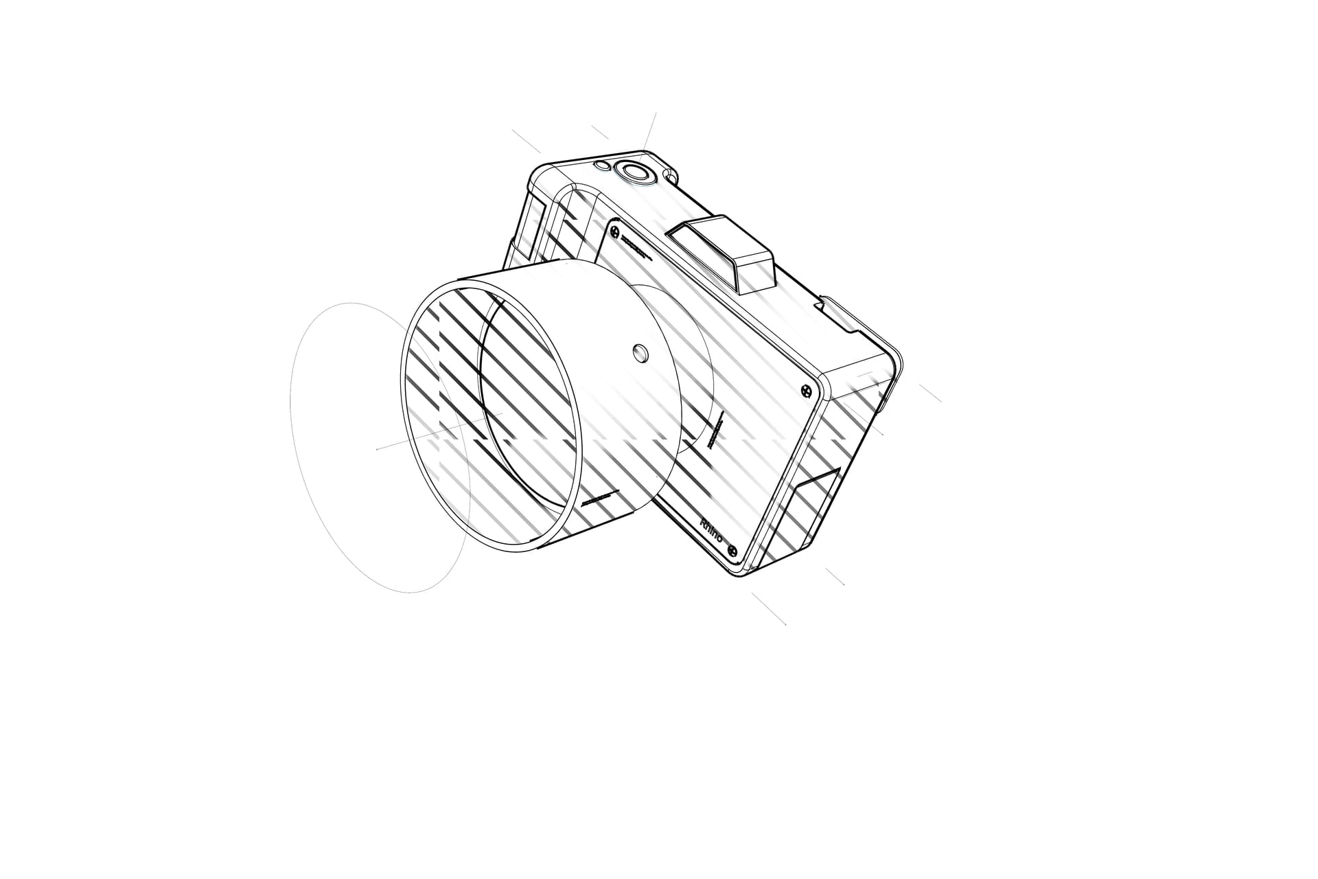

Tiling bug using ViewCaptureToFile with parallel lines shading
Using the “blackboard” custom display mode from the wiki (https://wiki.mcneel.com/_media/rhino/blackboard.zip) results in a tiling pattern of the parallel lines shading feature when using a higher resolution like 6000x4000 px with ViewCaptureToFile. Happens both with R7 and R8, shots attached. Additionally, the outlines in R8 looks cracked with gaps. Could you check both flaws?
Tried on another computer with an AMD RX 570 card an recent drivers, same tiling problem when wanting an image of 6000x4000 px. Can you repeat it?

Hi David -
Thanks for reporting!
We have this issue on our list as RH-76018 - “ssao tiling issue with high rez screen capture”
I’ve written this up as RH-77494 ViewCaptureToFile: Broken edges
RH-76018 is fixed in the latest BETA
I confirm that today’s build didn’t solve this specific issue, this is the display capture today.
f
Thanks for testing tay, here it’s also still broken.
