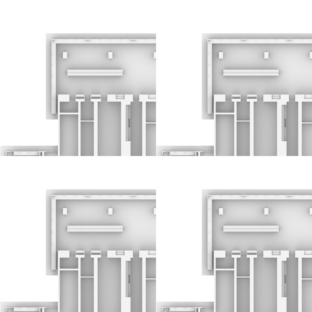

ViewCaptureToFile not working above certain resolution
Above a certain resolution (2000 × 2000 px in my case) ViewCaptureToFile will produce images with the top left quadrant tiled four times.

Do you also see this issue with a new, empty scene after adding just a sphere to it?
Yes:

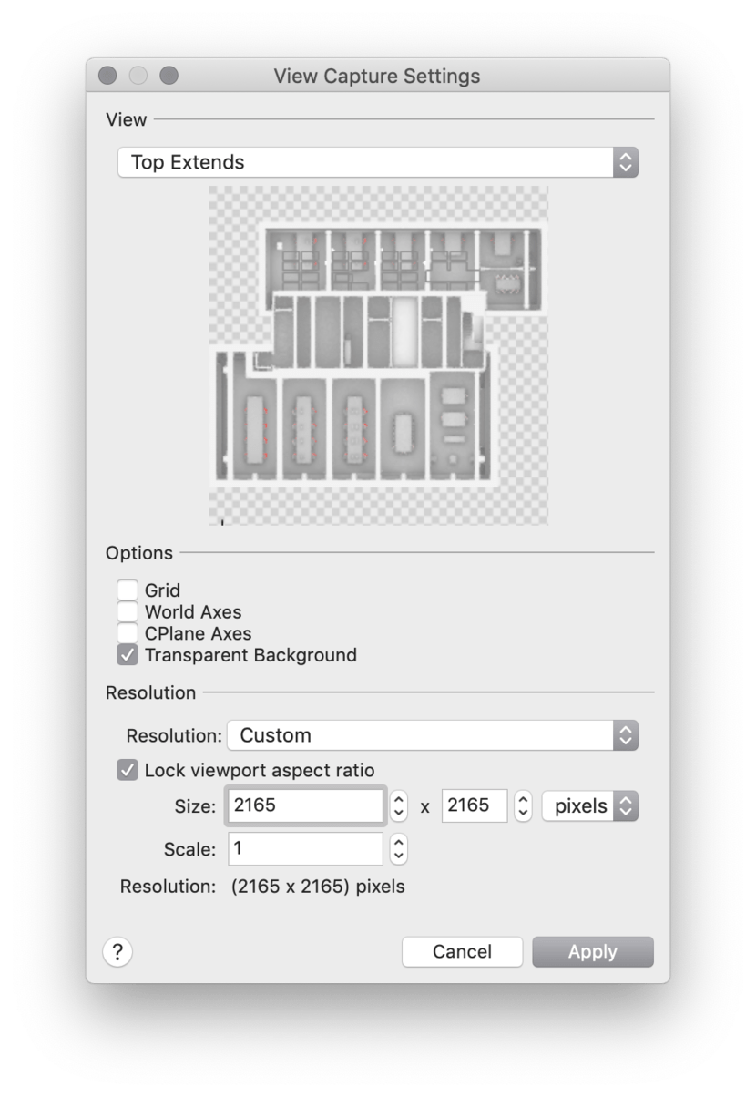

Hi @messismore,
I’m unable to reproduce the problem. Here’s a couple of questions:
  1. Can you take a screen shot of your ViewCaptureToFile dialog so that I can see all of the settings?
  2. Do you know if this used to happen with earlier versions? For example Rhino 7.5 or the original Rhino 7.0?
  3. Is there a reason you’re still on macOS Mojave? In case this is a GPU driver issue, it might be a good idea to try to be on the latest version.
-David

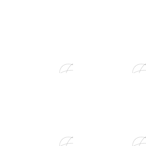

Pretty sure this has been happening for quite some time, probably in 7.0 and definitely in 7.5. I’m stuck on Mojave because I still depend on some 32bit applications (mostly CS6…). I hoped I could delay the upgrade until my migration to the Affinity suite has fully shaken out.
I did some more testing and there appears to be a pattern. Settings are the same as in the screenshot above, the only difference are the dimensions, as indicated in the filenames.
