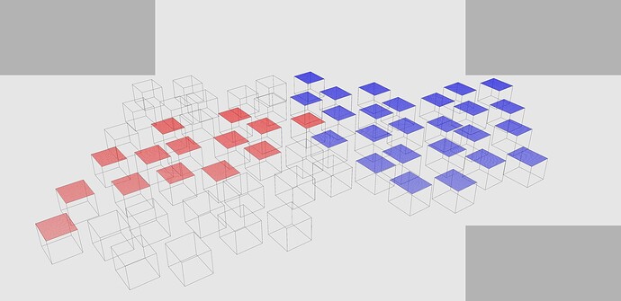

Third Issue
There is a sort of “Bucketing” that happens occasionally. I mostly encountered that with grasshopper objects.
A related post can be found here:
Rhino BETA - View Capture issue with grasshopper objects - Serengeti (Rhino 8 BETA) - McNeel Forum
Here is one scenario that combines all the results above.
Expected Results
ViewCaptureToFile 3x output
I’m attaching the file alongside the display model
Pender.ini (14.1 KB)
Test.3dm (711.7 KB)

Testing your file:
Viewport Screenshot
**Output from ViewCaptureToFile
Could you please also try a 3x resolution in ViewCaptureToFile?
yes these are 3x Captures
