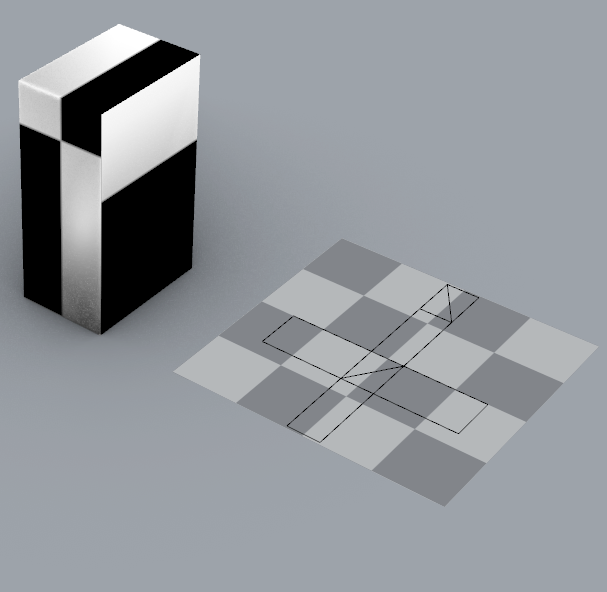

Hi Juan - if I choose the seams like so:
then the UV ediutor sees the mesh like so:
That is what you expect, right?
The rectangle is constrained, here, when I draw it.
That’s what I do but the rectangle is NOT
constrained. I don’t see that yours is either, the base and
top for example are rectangular on the box but almost square in
the UV map …
I would expect the flatten mesh to be the same than the unwraped
box if I was to unfold it.
Sorry I don't think I understand the process ...
Ah, OK, I thought you were referring to the base texture rectangle that the mesh is sitting on. That is constrained to being square and the texture is square.
Gotcha, so I’m the one that needs to draw a square (constraining the window with Ctl) regardless of whether the texture is square or rectangular and then the created mesh matches the proportions of the map inside the square. I understand now !!
However, I just noticed that choosing “Use material” only displays everything gray, not the actual texture …
