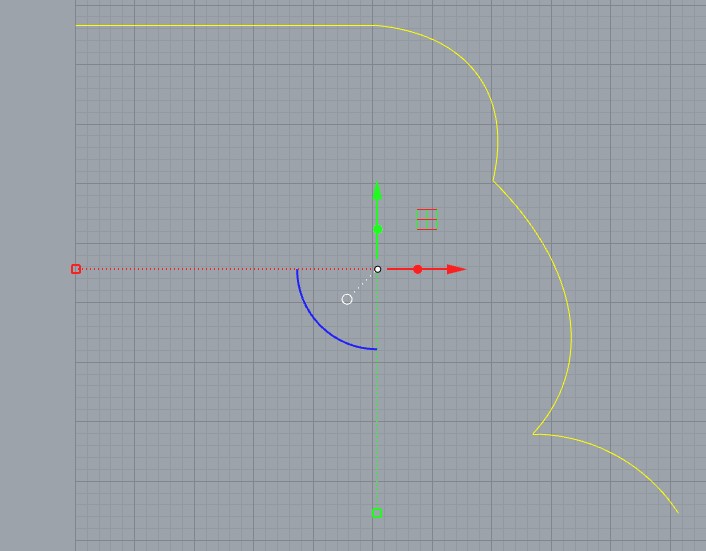

You can do that now using this icon:
There’s a command line Mode toggle that switches between Line and Arc:
yes i knows it!!! but the arc in this icon only support( direction and center) Method of Drawing arc. i suggest and need this arc support **{ startpoint+trough Point}**Method for draw arc in polyline

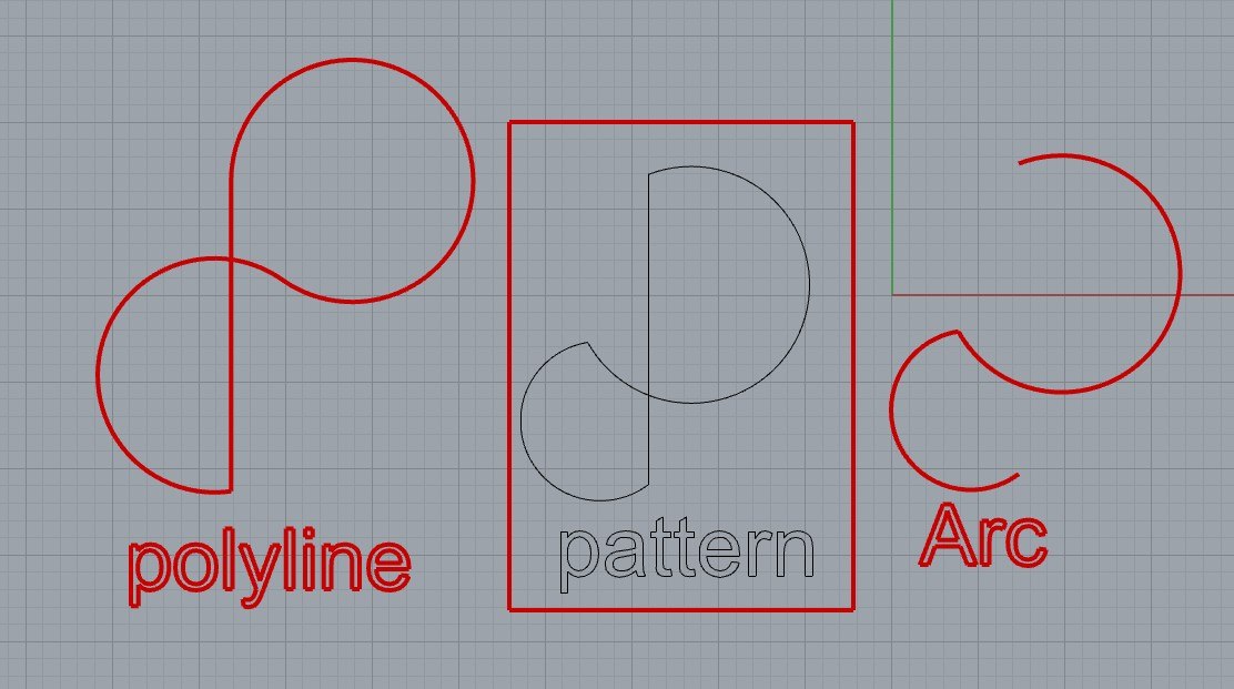

In this video, I compared the execution of the polyline command between Autocad and Rhino.
AutoCAD can be drawn directly on the shape below with the polyline command, but in Rhino, because the arc does not support{(startpoint+secondpoint+endpoint)or(startpoint+troghtpoint+endpoint)} this type of arc under the polyline command, it is not!

I was able to draw this using the Center and Direction command line tools.
Yes, it’s a different command pattern than AutoCAD, but it works fine.
You are correct that Rhino does not have the arc End and ThroughPoint options, but using Center and Direction, you can draw the same shape.

But unfortunately, you still can’t draw some shapes like AutoCAD with polyline(for example this shape below):point_down:
It looks like polyLine in rhino
When drawing an arc by polyline command, it wants to touch(*tangent to previous Arc or Line)
polyline.3dm (122.3 KB)
In addition, the polyline command may require a new command, such as polylinePlus, to create all the features of the arc and line without the need for a tangent.

I added a comment about your request to RH-58905. Maybe a new option TangentToPrevious=Yes/No can solve the problem?
I can draw the same polyline with the Direction option and SmartTrack,
But it is difficult to start the second arc with the correct tangent direction because SmartTrack cannot usually find it.
