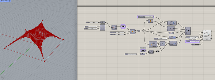

Hello grasshopper community,
Currently working on a tent simulation with Kangaroo, but as I lack experiences working with meshes. The script I followed only works with a rectangular shape. I am wondering if there are ways to subdivide any closed poly-curve into a mesh to be simulated with Kangaroo for the tent.
The main goal is to use the simple “Polygon” tool and have the tent adapt to the changing number of edges as it changes. I am hoping to develop it further in the future to divide more complex closed polycurves as well and simulate them.
Tent Structure.gh (15.5 KB)
Tensile Structure.3dm (67.0 KB)
Have you tried TriRemesh?
