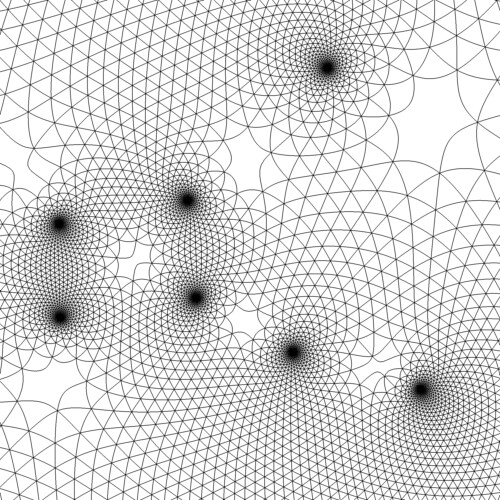

Hi all,
I’m trying to define a system that generates a diagrid canopy structure which resembles a force field (still stuck in 2D).
Each node should have a point charge and a spin force so that the final outcome is 3 sets of curves:
1. Field lines spinning CCW
2. Field lines spinning CW (create diamond shapes)
3. Equipotential ‘ring-like’ closed curves that divide the diamonds into triangles.
I’ve managed to get this far (Just field lines at this stage. Every node should become a column later on):

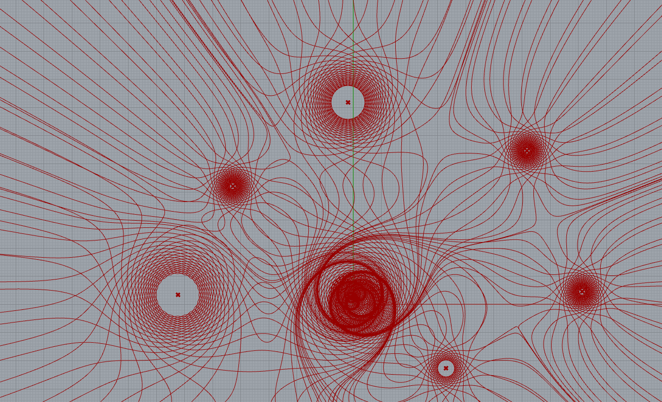

Things got a little complicated for me when I tried to get the field lines to work in the other direction.
I’m getting nice curves locally but the farther I go from the nodes it becomes messy:
