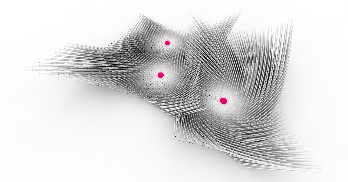

Hello guys! Could anyone help me or just guide me how can I achieve something like this?
Thank you in advance!

Bumaye Thank you for your interest. The truth is that I have already checked most of them but they have to do with curves mostly. I was wondering, for example, how I could use the spin force field in order to move objects or transform their shape. In other words instead of creating curves based on a spin field if it is possible to create vectors who affect a shape based on a spin force.

The images seems to be from there !
Yes but unfortunately there is no script or info about the process…
There is a description so I try to make something
Is something like that useful for you ?
Yes Laurent…Thank you for your time…It could be a nice start to experiment a little…
Here a little script derived from magnetic field from paragroup (https://www.paragroup.org/code)The idea is simple use magnetic field to generate some direction and rotate curves depending on distance (could be magnetic force)
