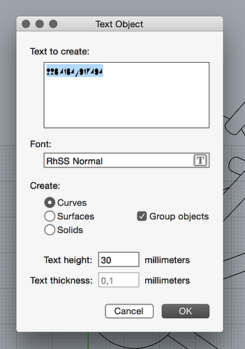

I hate to be the bearer of bad news, but for me the RhSS font only generates weird outlines. I have no option of selecting single stroke font. I am not sure how this can be a solution for mac users. Maybe I’m doing something wrong?
Hi - you need to use the TextObject command to get the Allow single stroke fonts option.
Hi Wim, I am using that command. Somehow it doesn’t show up for me, see my screenshot :slight_smile:

Hoi Marinus - that is expected behavior.
As Mary wrote above:
Don’t be disappointed when you see it.
In that dialog box the text will appear like that but when you create the TextObject in the viewport, it should look fine.
Ohhhkay, so it’s supposed to look like this?
Hi Marinus - no that’s not supposed to look like that.
I see that it does that in Rhino 5 here as well but it’s fixed in Rhino 6. Have you tried running the Rhino 6 Beta?

Thanks @jeff_hammond and @wim , I ā€˜assumed’ it was because this option was mentioned back in 2015. I don’t think Rhino 6 was already in beta back then? So I expected this to be in Rhino 5. Sadly I cannot partake in the beta, my system is still on Yosemite because I am using a few pieces of software that don’t work above Yosemite… So I can’t make the switch. Even though I’d love to!
