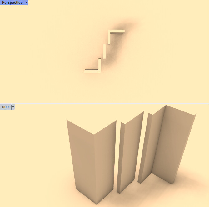

Hello, I really don’t understand what is going on with the shadow and rendering here.
I have reset both the Render and Raytracing modes.
Render mode simply does not cast shadows
Raytracing is giving some really wierd results after 1000 passes
any ideas?

This is the corner of a building, you can see from the projected shadow of the ducts that the sun comes from the left. the face on the right should be darker (much darker). In the rendering mode there are simply no shadows. Distance to origin is reasonable (65 meters).
raytracing 1000×: image
rendered mode: image

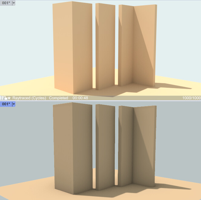

I guess I have two complaints in this thread (which is never good).
  1. One issue is: In the rendered mode, the cast shadow disappears with the extent of the scene, even with very minimum geometry. In the attached file, besides the test with the increasing planes, I moved one wall 100 meters away. Even with the 20×20 plane the cast shadow dissolves. This is likely at the origin of a previous complaint ( Quick Question: should display mode rendered show shadows when sun is on? - Rhino / Rhino for Windows - McNeel Forum).
    Open the attached file; sequentially turn on layers plane200x200 and plane400x400; then turn off those two layers and turn on Geom100m.
    20×20 > > 400×400
  2. The other issue is: Both in raytracing mode and in rendered mode, the face shade is very faint, especially in contrast with the cast shadow that ends abruptly on the corner. The shaded surface should be closer to the cast shadow, than to the lit surface. In fact in the examples below, it actually looks that the shaded faces are lighter than the lit faces…
    Open the attached file and notice is on views 001 in rendered and raytraced mode.
N
This is because you have an environment in your skylight that lights from that side as well

I can’t speak much to Rendered mode, Raytraced is my area. But again, the default environment you use is also set to be the skylight custom environment. The orientation it is at will light from the side you saw the shadow “abruptly ending”.
You need either to find a skylight environment that has sun-like light source in roughly same location. Or add a basic environment and set as texture Physical Sky Texture with Use Document Sun checked.

In Rendered mode, the resolution of the shadow map that we create depends on the extent of the scene, because the shadow might extend that far in the worst case. The larger the scene, the less shadow detail on a specific area in the scene. It’s not ideal, but it has been like this for several Rhino versions.
You can improve the situation by increasing the maximum shadow map resolution in the Shadows settings (Rhino Options → View → Display Modes → Rendered → Shadows → Video Memory usage / Shadow Size). Drag the slider to Maximum and it should look much better (although not perfect).
Does this solve your problem?
