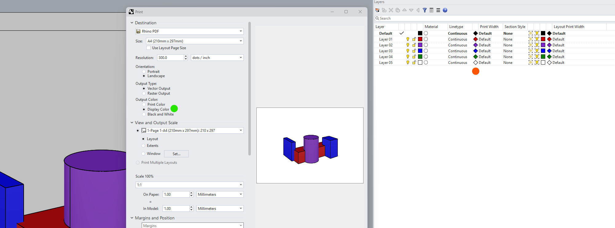

May I still ask: shaded is automatically printed with raster ?
If I print Shaded with black edges, the preview doesn’t match and I get coloured edges and raster output.
Shaded.ini (8.2 KB)
You can specify to use the Display Color in the Print settings vs the Print Color (default)
Not sure to follow why we put the print colours back to the layer colour to print it in black though.
Sorry, probably too many display modes and too much confusions on my side…
Long story short: there is then no way to print a pdf of brep with the faces coloured and the lines in black, as vector? And even less with a silhouette.
Am I also understanding it correctly: when I print a Shaded view using vector output, it is overwritten to raster?
Which means, only the Wireframe and Technical default Display Modes are printable using vector output?
Correct. Vector only applies to certain objects, as per the help documentation.
Fill being a Planar Hatch, not a color per say.
You can use a screen capture as background image, which will be visible in vector print.
