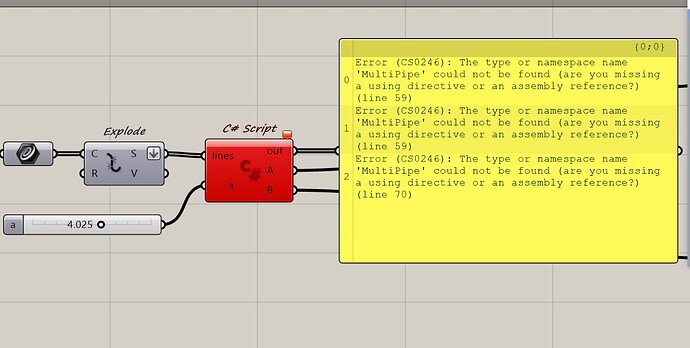

hi @DanielPiker when i use it c # component this error
Do you know the cause -My Version is Rhino7 Sr11
In the previous version of Rhino7 this error was not and the component was properly
Ah yes, the namespace was changed in a recent version.
So scripts like this one which reference it need to use eg
‘MultiPipeMethods.HalfEdgeGraph’
instead of
‘MultiPipe.HalfEdgeGraph’
Here’s an updated version of the script from above with this changed:
multipipe_separate_nodes.gh (11.4 KB)
