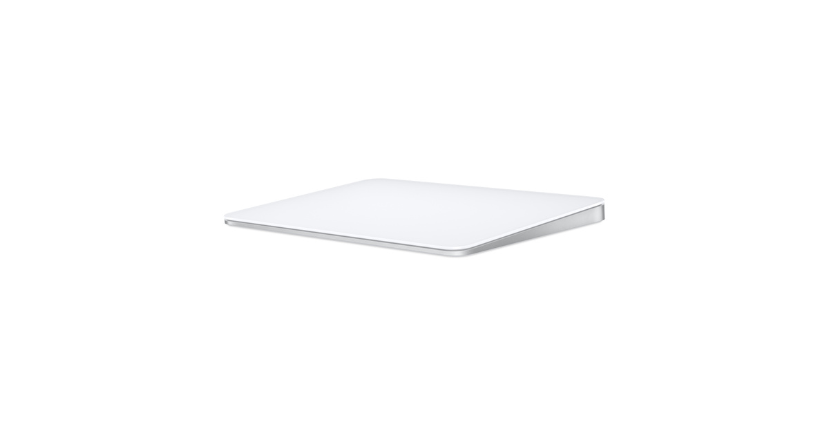

Very interesting suggestions. You should be able to use a mouse/trackpad
But to answer your question, there isn’t at this point a way to control the app with your voice. Let me know if none of the solutions above work for you and we’ll look into it.
