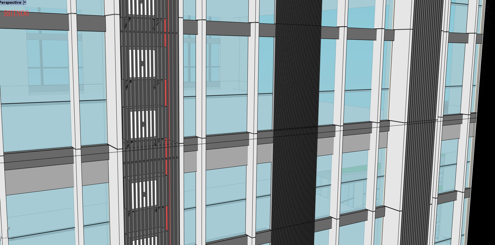

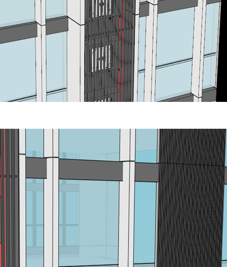

I am tryting to switch from 5 to 6. The display differentiation, which I feel quite confusing.
Under identical display modes, Rhino5 show more detail and fine lines than Rhino6.
And the rotate view, pan, is also smoother than Rhino6.
Both softwares use antialiasing 8, you can easily see Rhino5 is more elegent.
So, is there any settting I was missing? and why RH6 is worse regarding to the aspect of display?

In the shade mode, V6 performs faster that 5. But in the uploaded mode, 6 Becomes very slow and heavy. 5 is slow as well but at least I can pan and rotate the model, which in 6 needs mins for its responding.
