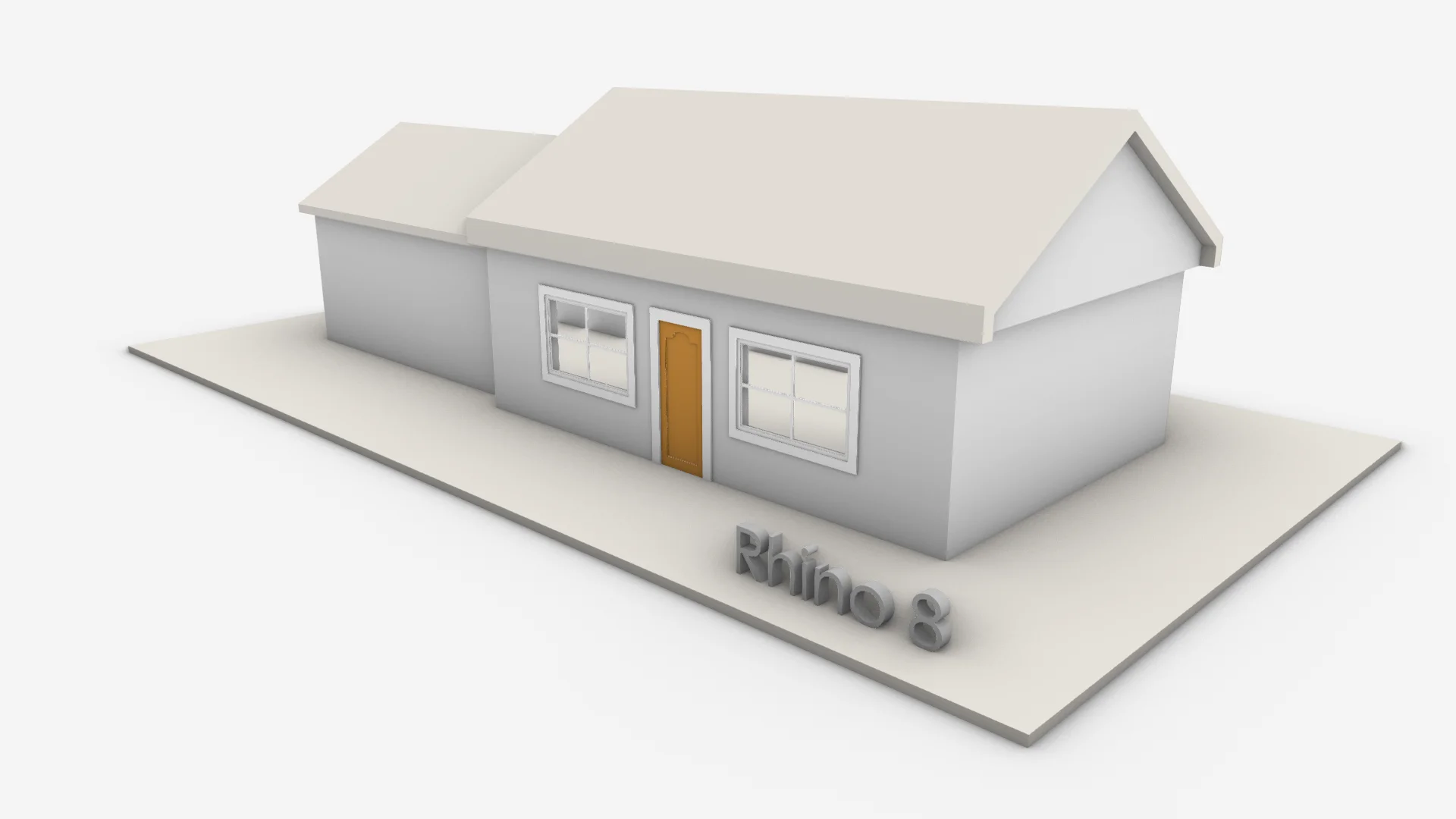

Hi all,
In the Rhino WIP several new enhancements and additions have been made to create a PushPull workflow. The new enhancements ease the manipulation of solids without needing to trim or split as well as working in perspective views.
