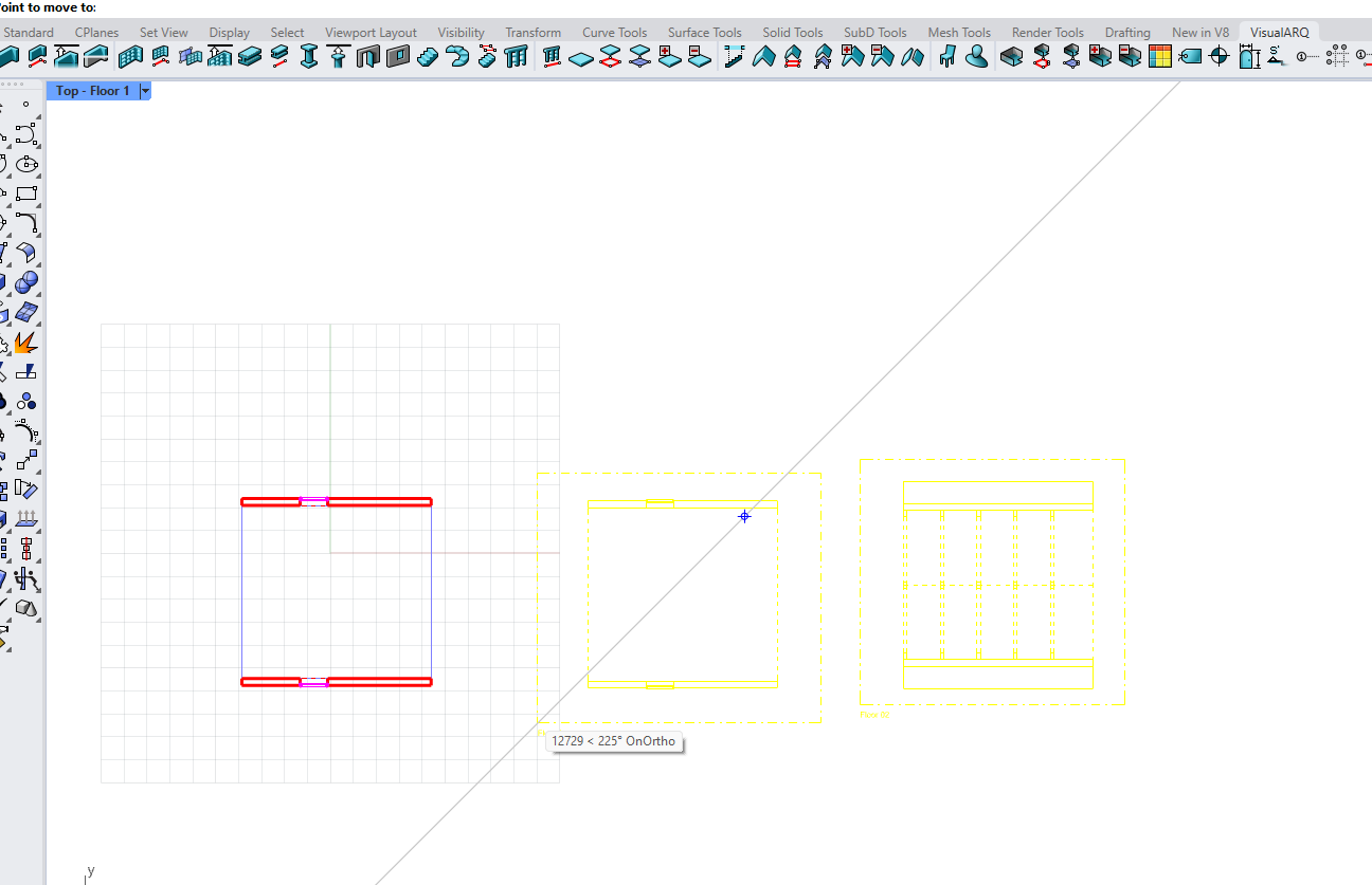

I have a recurring problem where dragging or moving a vaPlanView often crashes my file.
I made a test file that i attached. It crashes sometimes when moving a single PlanView but crashes every time i move 2:
Model:
planviews:
Tried to take a snapshot when moving them:
This crashes the file (attached)
test.3dm (8.4 MB)
Hi @Jens_Jacob_Melhus_J1 I could reproduce this crash. We wil fix it as soon as possible. I’ll keep you posted.

Thanks Alex, I assume this is the same error. In any case, if you can also share some sample files where this crash happens, we will verify it is the same error and make sure the fix works for both cases.
@Jens_Jacob_Melhus_J1 I let you know that we fixed the crash when moving those plan views in the VisualARQ 3.7.2 update: Update - VisualARQ
