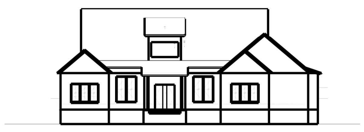

Has anyone having print issues come across this?
Layout Space (Technical View Mode, Hidden Lines Off):
Printed Rhino PDF Result (Vector, Technical View Mode, Hidden Lines Off, Black & White Display Colors):
Note how open curves are showing through the elevation view from the doors/windows beyond.
Hidden lines are not enabled, ghost and transparency settings are not enabled.
Also if I switch the Print Dialogue to “Raster” it previews correctly and prints without the extra door/window lines showing through the building but then the line widths are messed up (despite no settings other than Raster/Vector being changed)

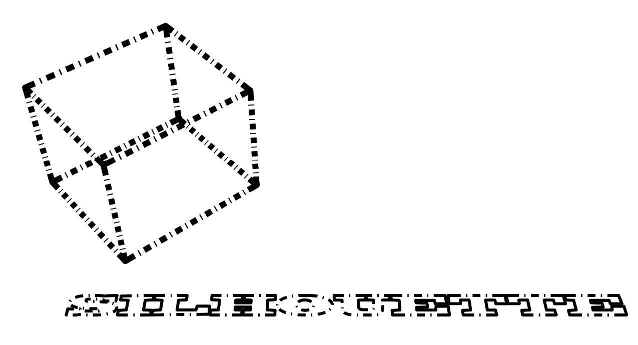

The Line Thickness issues can be broken into 4 distinct Issues.
1- (Vector and Raster) Line Weight Scaling (This is exclusive to the newly released LineTypes) between Model Space and Layout Space. Reported Here
2- (Vector) Inconsistent Linetype Scaling between Curves and 3D Objects. lile the below
In the image below, Both Objects have the same Linetype assigned to them, the curves shows somehow properly with the correct linetype but the box does not.
3- (Raster) Inconsistent print Widths. in this case the 3D object shows double the thickness of the curves although both of the object types have the same linetype assigned to. like the image below
4- (Vector and Raster) When Object Thickness is Set to a Value in Pixel, it will be ignored.
@stevebaer @Trav
For Both (Vector & Raster) The issue of the newly introduced Linetypes lacks the idea of WYSIWYG (What you see is what you get) I am expected to waste a lot of hours test printing things, because it is guaranteed that, My Linewidth in the Model will never translate or scale properly in the Layout and it will never print correctly in either Vector, Raster or Both. Despite my excitement for the new features and capabilities, I find it impossible to generate a printable package of my design.
