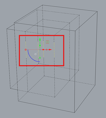

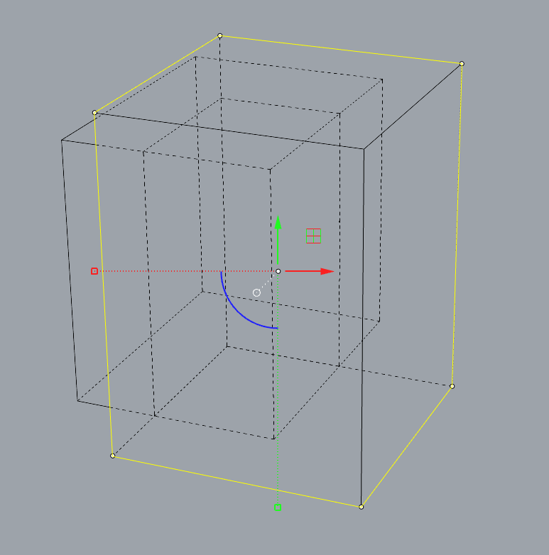

I’ve just been experimenting with rhino 8 print to PDF that i see now supports vector output. I’m using the rhino print to pdf option.
I’ve noticed when in hidden line mode, hidden lined prints into separate entities – will this be enhanced in R9? i.e. printing to layers as continuous dotted-line line definitions etc?
The two attachments loosely show the issue currently. The pdf files have been inserted back into the rhino file. The hidden lines are broken up whereas the solid outline (non-hidden) are continuous. It would be great to see these map more like a make 2d definition if at all possible.

I’m not finding such YouTrack report, no. And I’m not sure it’s even desirable. Do you have other PDF creating tools where you can create curves with dashes in a PDF file?
In a quick test here, exporting such from Inkscape to PDF and importing that PDF file into Rhino creates a single curve without linetype dashes. Any other application out there that uses the same PDF toolkit, also won’t see dashes. As long as that’s the case, it’s possibly better to create multiple short curves.
