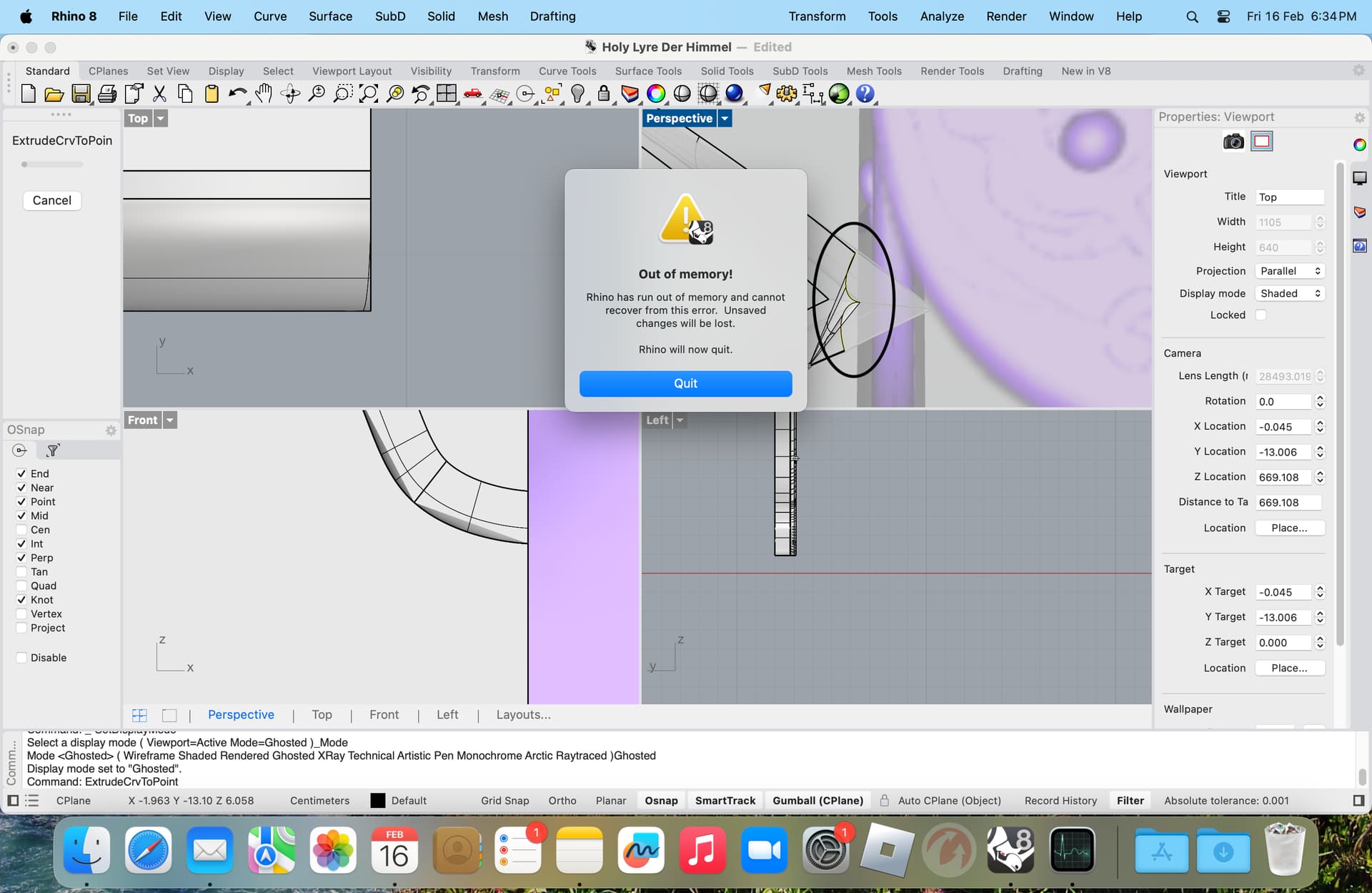

Hi there so I was working on a project of mine when rhino gave me an out of memory error and forced me to exit. I am unable to find the source of the error but am able to replicate it by using the ExtrudeCrvToPoint command on 2 open curves as seen in the picture below (circled)

And here is the 3dm file at the moment before the error occurs:

hi @Isaac_Lo it’s not very clear from the screenshot and model what you are doing exactly.
Hi Gijs, sorry about that
I’m trying to use the ExtrudeCrvToPoint command to connect these 2 curves (arrowed in the perspective viewport, located on the model by the 3rd larger arrow at the front viewport) to a point, but I get an out of memory error whenever I try to do so.
hi @Isaac_Lo I see this, thanks for reporting,
apart from the bug, I’d like to suggest a different method for those corners. If you use ExtendSrf on the ‘fillets’ and then trim the surfaces back on each other, you will get something like this:
i’m on pc, no issues here with the extrudetopoint…
RH-80508 Out of memory with ExtrudeCrvToPoint
