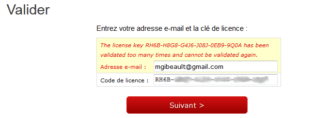

And now, when trying to get a validation code from the website, I get this message:
The license key RH?B-XXXX-XXXX-XXXX-XXXX-XXXX has been validated too many times and cannot be validated again.
Please help me @brian, this comes at a pretty bad time…
