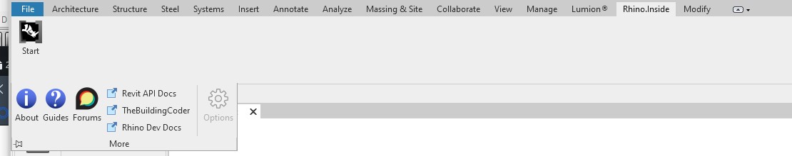

Heyyyy… I have the same issue… and I think I followed most of the great advice here, and restarted a bunch of times… even reinstalled Revit and deinstalled other Revit-apps that might be conflicting…
So when I try to start RhinoInside by pushing the start-button, nothing happens. I just updated to the latest WIP, and didn’t have any trouble with the last one.
I have trouble sorting out which installation-path I should enter through this thread so I wanted to double-check with you if this is correct?
Would be very thankful for any hints on what to try next as I’m on a deadline :upside_down_face:
installation path
… for the record, it won’t load in earlier versions of Revit either…
Have a nice day! Greetings from Norway

Hi @sigurd,
You mention “Last version worked, updated …” do you refer to Rhino.Inside, Rhino or Revit?
When you said “…and now it does not start” you mean:
  • Rhino.Inside does not appear on Revit UI at all.
  • It appears but gives you an error message when click on ‘Start’.
I see on your screenshoot that you are using Revit 2020 but you mention it is installed on %PROGRAMDATA%\Autodesk\Revit\Addins\2021 is it also installed at %PROGRAMDATA%\Autodesk\Revit\Addins\2020?
Hi Kike,
Thank you for replying!
  • “Last version worked” refers to the previous Rhino.Inside
By it does not start now i mean;
  • Rhino button appears in Revit, but nothing happens when i press it. (on the previous rhino.inside version there was a toolbar with several buttons i remember). No error messages when i press it.
**" I see on your screenshoot that you are using Revit 2020 but you mention it is installed on %PROGRAMDATA%\Autodesk\Revit\Addins\2021 is it also installed at %PROGRAMDATA%\Autodesk\Revit\Addins\2020 ?"
– Sorry! I copied that text from a previous post and forgot to change to 2020. Yes it is installed in `%PROGRAMDATA%\Autodesk\Revit\Addins\2020.
