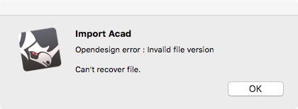

Having a similar issue. I just imported a dwg file to Rhino but I have even a smaller dwg I can’t seem to import it. Giving the same error mentioned in the openning post and after I click “ok” another error of window appears “Opendesign error: Invalid file version. Can’t recover file”
EDIT: Solved the problem by saving the file as AutoCad 2013 file and then, importing to Rhino 5.

dwgs failing on import: each acad version 2018 down to 2004
"Error importing file [filename]"
acad 2000 is successful
anyone else having this issue?
