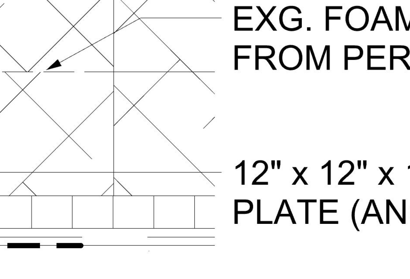

When printing a single layout, with the Vector box checked, RhinoPDF prints to vectors. when printing to multiple pages, it prints layouts to bitmap/rasters.
Vector Box:
When printed as just one Layout:
zoomed in:
when printed with multiple pages:
zoomed in, clearly a bitmap…

this also has a significant effect on filesize of the PDF, where 1 page (vector Output) is around 1MB, and 3 pages (raster bug) is 12MB.
Also, the display mode is wireframe in all of these viewports.
