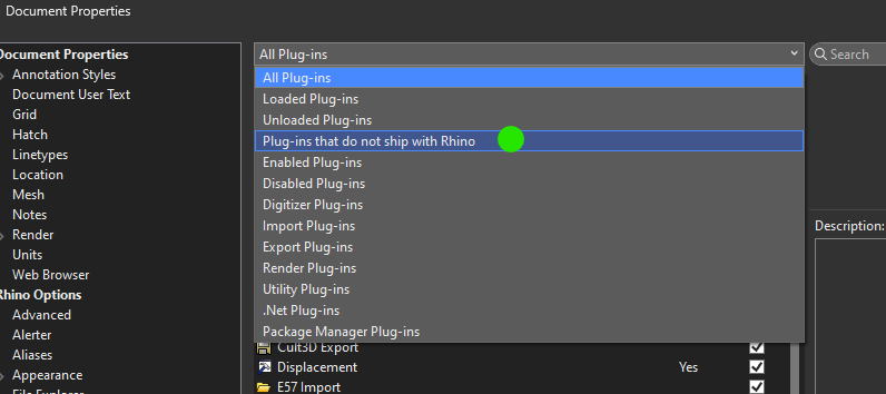

We should disable these for troubleshooting, particularly the ones referencing older versions of Rhino.
Go to File>Properties>Plugins and sort by Plugins that do not ship with Rhino & disable, then restart Rhino.

Not familiar with this one. You can isolate Rhino + Enscape from other 3rd party plugins by going into File>Properties>Plugins and sort by Plugins that do not ship w/ Rhino. Disable and Restart Rhino after changes.
Try removing this.
