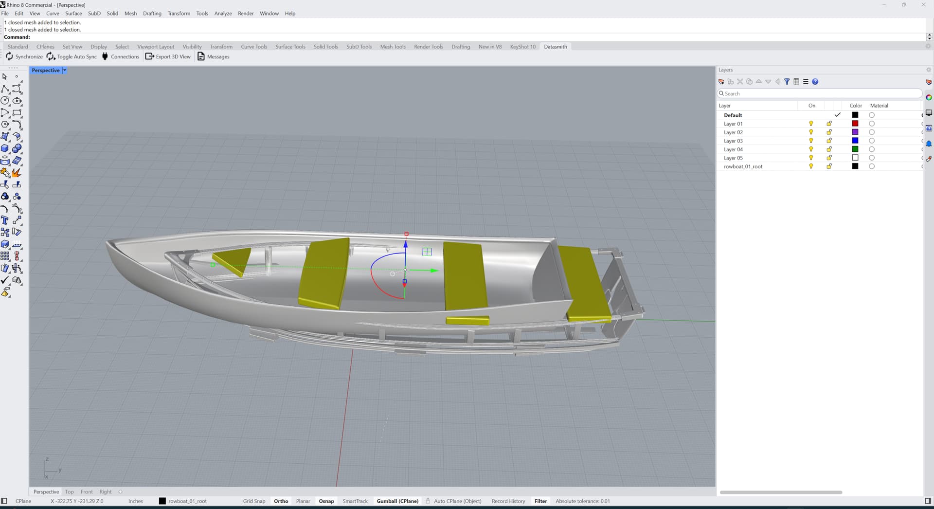

Hello, I am continuously having the same issue and can’t seem to figure out the cause, because I never had the issue in any previous versions of Rhino. I download a free model (usually from Adobe Substance 3d assets), an FBX file and its included in my Adobe subscription. When I import to Rhino 8, it comes in with the geometries on different meshes shifted in position, as if like say they are both importing with a different “base point”, so its basically useless. For example, a rowboat frame might be shifted 2ft away from the rowboat metal skin. The workaround has been to open the FBX in blender, looks completely normal, then select all objects and “ctrl J” to join them, then reexport as FBX. This seems to open in Rhino fine and can be exploded. Please help with any insight, its crazy frustrating to have to work in Blender just to get this to work. Its probably some setting I don’t have checked or something. Thank you in advance!
you can see what I’m talking about here, the positions on boat skin, boat frame, and seats are not where they are supposed to be . All i did was drag an fbx onto a blank canvas Rhino 8 — import ----yes to the scaling question :

Hi Chris - thanks for the report - this model comes in correctly arranged but wrongly oriented if I do not ask to map the Y-Up on opening.
RemapCPlane Top to Front will get it oriented right - that might work OK until we get it fixed.
RH-80890 Opoen fbx: scattered if Y up

Hi Chris - on the File > open dialog, poke on Options button.
ah yes, that did the trick. THANK YOU. yea, that allows it to import correctly but I then just need to rotate 90degrees. still annoying but not as bad. haha. appreciate the help. weird flaw…
Hi Chris - on Import, the objects will be selected - run this macro:
! _Rotate3D W0 W1,0,0 Copy=No 90
