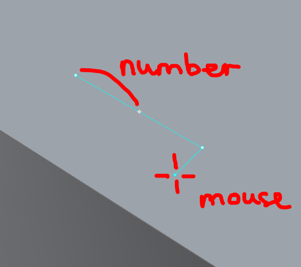

One quick question, recently I notice when I draw polyline/line, the curve is followed where my mouse is clicking instead of sticking to the numbers I type. Is there anyway to solve this?

Hello - please update to the most recent service release.
https://www.rhino3d.com/download/rhino-for-windows/7/latest
Thanks for reply Pascal! Unfortunately still not working, I think itâs probably because of some settings in the options? Do you have any clue where is this?
Hello - hmmm- can you please run the SystemInfo
command in Rhino, and copy/paste the results here.
Please find info below. I just realized itâs probably because of the âDistance Constraintâ. In rhino 6 when you draw curve/line seems only need to type in numbers and it will automatically use âDistance constraintâ. But in rhino 7 it requires you to type âEnterâ after typing the number. Is that ture?

Hello - you just need to get the latest - the initial 7.4 had the bug you describe but it is fixed in a âhotfixâ release for 7.4 and in 7.5
Amazing thatâs working, thank you Pascal!
