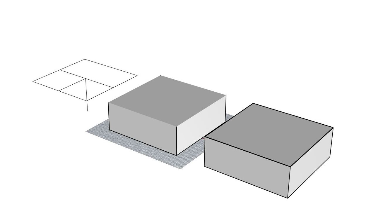

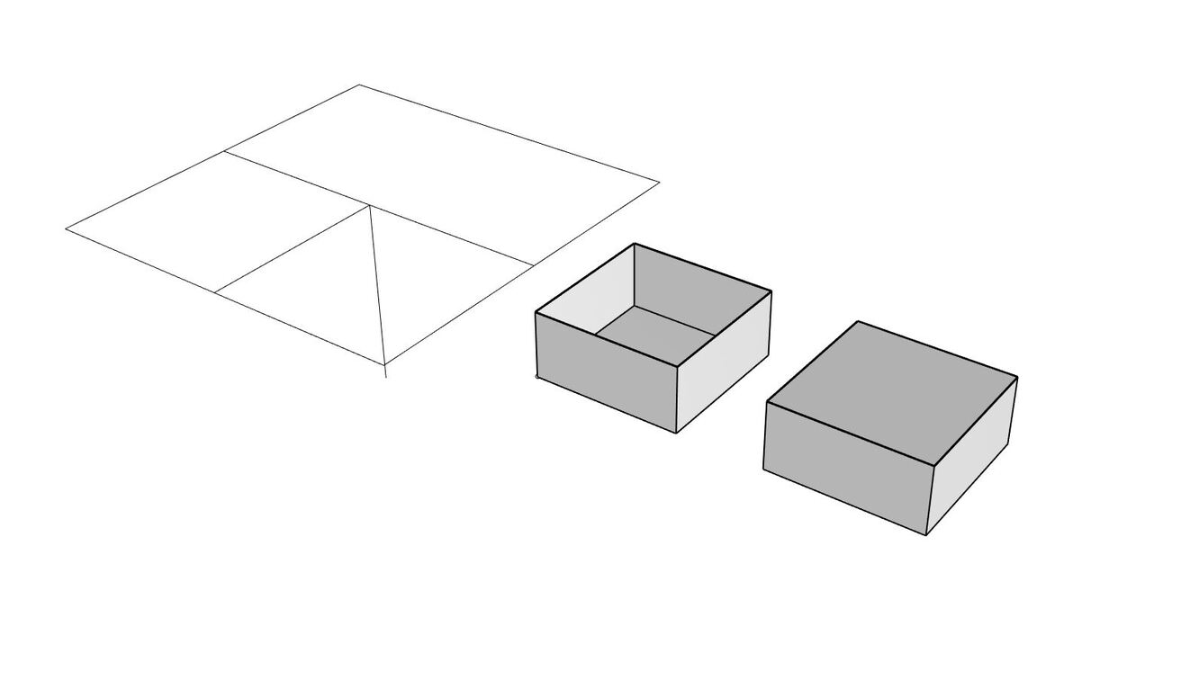

Not sure what the status is but I’ve encountered issues with this as well please see below a list of images and different behavior as well as a file containing the geometry.
steps to replicate issues (units mm):
  1. create a box in origin 100,100,100.
    2.copy to the side and create a block with the origin of the block being the left bottom corner
  2. create a new box in 1000000,1000000,1000000 with same dimensions as above 100,100,100
  3. copy next to it and create block with its origin bottom left corner
  4. create a clipping plane for the objects far away and one for the objects next to origin
In my file I have named the objects next to the origin “origin” and the ones far away “far” for easier navigation.
Looking forward to thoughts regarding this issue.
Best,
Tudor
190321_BlocksClippingPlane.3dm (73.0 KB)
