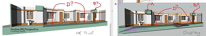

Clipping PLane fill seems to be a bit improved since my last post on this in September.
At least it seems to be consistently printing in the correct color, which is a huge improvement.
What I’m after in the above print is a solid green fill on the architectural shapes, which are set to render in section as a solid fill.
I welcome any workarounds for these problems:
Issues:
  1. The result contains unwanted shadows which display with one set of anomalies and print with another. (Items A, B, and D.)
  2. The human figure objects in the rendering are set not to have a solid fill. They display without them but print with them
  3. Part of a furniture object displays unclipped and prints clipped…
Hello Pascal and Alan_Farkas,
In my personal experience the clipping plane fill will not work when you are trying to clip an object that is not a closed poly-surface of brep. If its a complicated poly surface try checking your edges and fixing any micro edge loops
