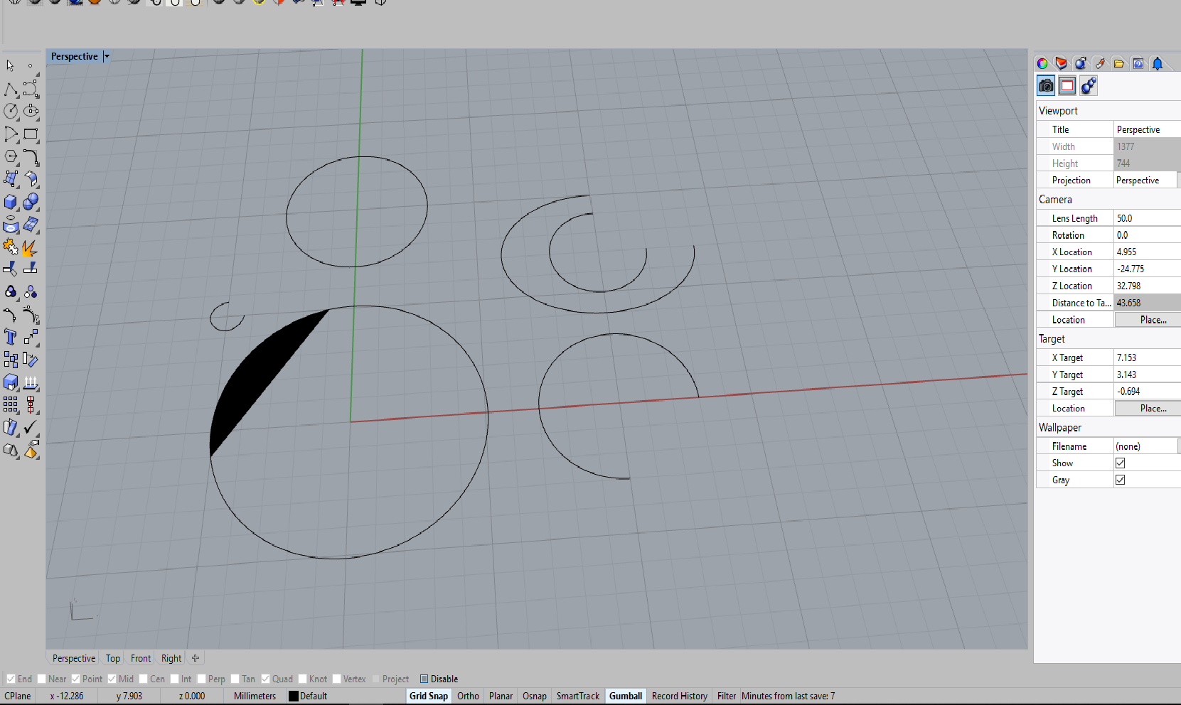

I recently installed Rhino 6, but im having a strange problem with my curve tools
If i use the circle command, the circle does not close properly and it seems to glitch a lot as i rotate my camera.
i have repaired it, reinstalled it and updated it to the latest version but the problem persists.
I do not have this problem with rhino 5
If anyone can help, id be very grateful

Hmm, saw something here recently that was very similar, can’t find it now. This is most likely graphics card/driver related. Can you run SystemInfo inside Rhino and post the results here?

try updating your video driver.
Definitely… 2015.
In Rhino 6, you should have a Notification tab over there with Layers/Properties/Help/etc.
The notification panel should have a warning about your ATI driver.
Double click and see if you can use that to get it updated.
