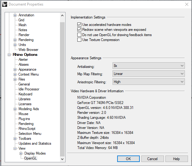

Seems I’ve found my culprit.
Since the last major WIN10 update, Rhino 5 is not able to notice driver version or date.
At least that is what it looks like… ?
(Although it does mention correct driver in OpenGL)
I’ve already tried older and the newest drivers… no luck ;S
Total video memory is way off though…
any suggestions?

However, i can see that the GPU driver and date is weird in v6, as well.
The dedicated video memory (total video memory) is also weird here… should be 2048 MB
Only thing i can say for sure, is that the issue/bug/problem arose after last major win10 update.

Basically because of what the viewports look like when selecting a specific port. (screenshot 1 & 2)
1:
2:
Alhough the graphical abnormality “corrects” itself when selecting the same viewport one extra time or I start moving geometry or move the camera. (screenshot 3)
3:
