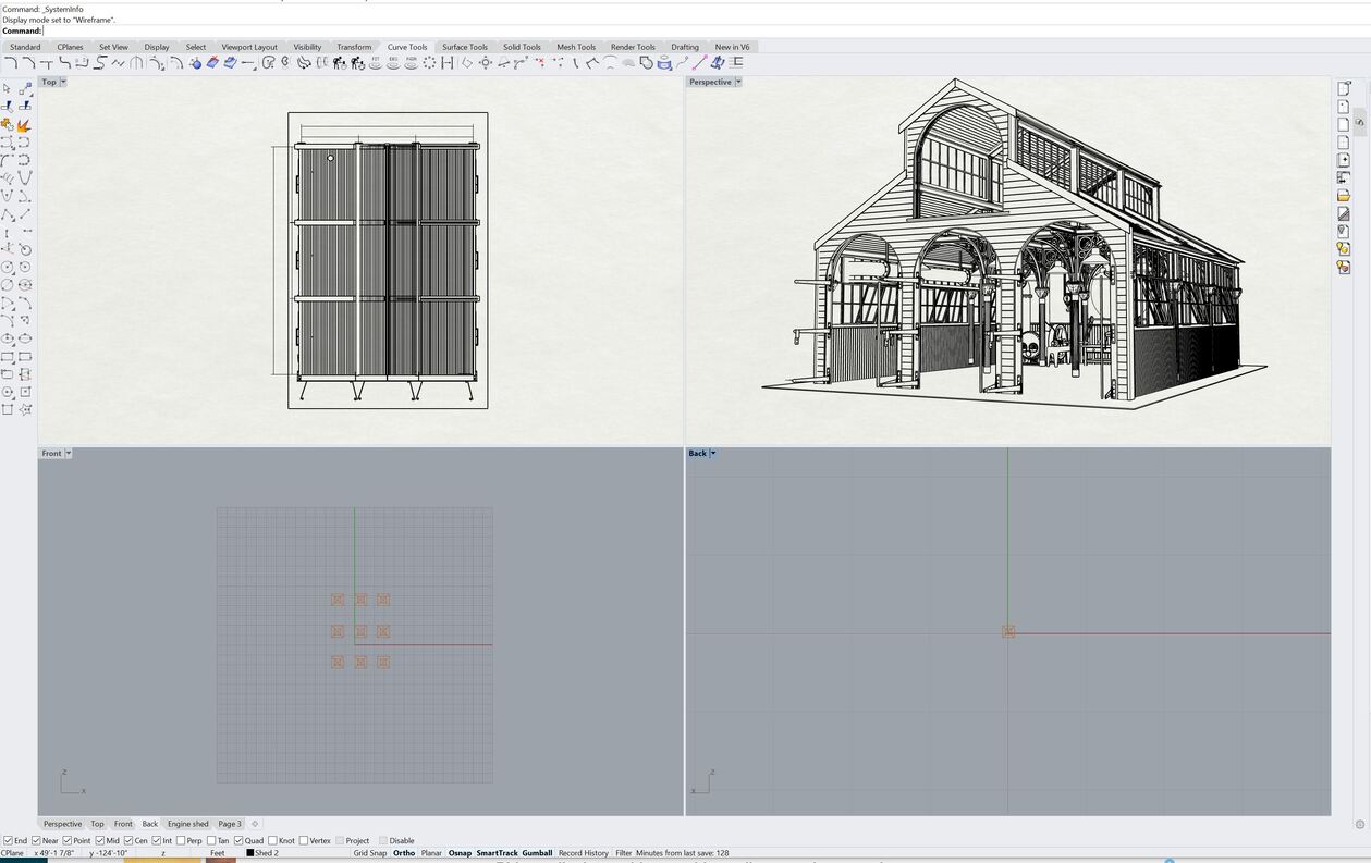

Hi Mercedes -
You have 2 GPUs in your machine. Both are below the minimum recommended specifications to run Rhino 6. The thing is, Windows has set the weakest of the two to be your primary OpenGL device.
If you somehow get the other card to be primary, perhaps you would have fewer issues with running Rhino on that machine. I don’t know if there is an AMD tool on your PC to control this or if you could try disabling the Radeon R7 in the Windows device manager…
I have the same issue, using a trial of Rhino 6.
I was simply attaching two curves to each other and both of the front and back views disappeared from my viewport.
I have updated my driver as suggested.
Is this a Rhino bug - certainly feels like it, was perfectly fine before and works perfectly OK on other files.
Thanks

your driver is still a year old… can you verify that it has in fact been updated?
