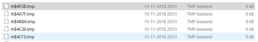

Trying to figure out what the actual bug/problem is here. I think the current problem is:
I got the error “Unable to open temp clipboard file C:\Users\harm\AppData\Local\Temp\rh$A08A.tmp” and Crtl+c didn’t work anymore
If this is the case it has nothing at all to do with Flamingo but is a copy/paste issue. This is what Rhino does when running copy/paste:

I can confirm that the copy paste problem probably has nothing to do with flamingo. I just tried crtl+c and crtl+v again, and again it is not working.
@JohnM yes the temporary file does exist, however it’s size is 0kb. Could you tell me how to upload the file because i don’t know how to do it on this forum.
@h.coster If the file size is 0 then you don’t need to upload anything. I think that’s what the problem is though. Being 0 (i.e., empty) there is nothing to paste. I guess we need to find out why that file was created empty. @johnm Any ideas?
What kind of objects are you trying to copy/paste? Can you press F2 after it fails and copy the error message from the command history window?
I just copy simple object like a simple solid box.

Command: '_CopyToClipboard
Unable to open temp clipboard file C:\Users\harm\AppData\Local\Temp\rh$3DD8.tmp
for writing
Command: History
Rhino history settings ( Record=Yes Update=Yes Lock=No BrokenHistoryWarning=Yes RecordAnnotationHistory=Yes )
1 extrusion added to selection.
Unable to open temp clipboard file C:\Users\harm\AppData\Local\Temp\rh$D6AE.tmp
for writing
Command: _CommandHistory
The “Unable to open temp clipboard file C:\Users\harm\AppData\Local\Temp\rh$D6AE.tmp for writing” means Rhino was unable to open the temporary file for writing in your Windows system temp folder which is not suppose to happen. I would close all currently running applications, reboot your computer and follow these Microsoft instructions for cleaning up your temporary files folder.
