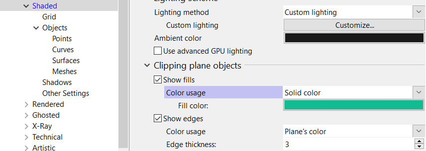

I start with a factory-default Shaded display mode.
The only 2 things that I change to this display mode are:
  • [Shaded] > Clipping plane objects > Color usage -> Solid color
  • [Shaded] > Clipping plane objects > Fill color -> some color
In the viewport, my object now looks like this:

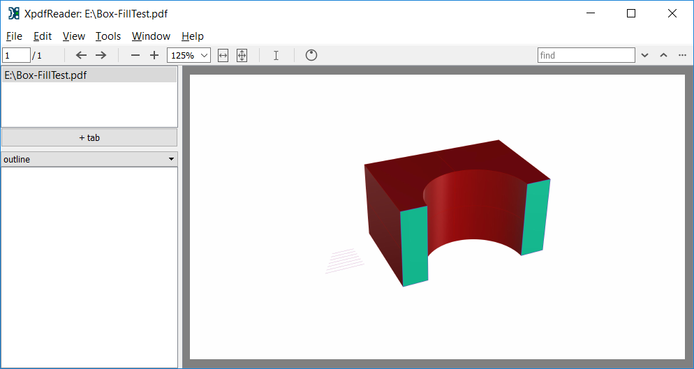

The print preview looks like this:
And the final PDF looks like this:
Are you saying that this procedure doesn’t work on your end?

The problem with the fill color in regular viewports is not something I can reproduce on my machine. I get this when I open your file with your Shaded display mode:
It’s definitely worth a try to install SR10 and check if the fixes also solved this.
