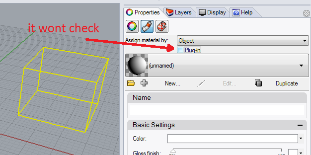

Installed SR5:
(still the trimmed surface texture mapping is wrong, as said in other discussion see here:
http://v5.rhino3d.com/forum/topics/pictureframe-trim?commentId=6377196%3AComment%3A134384 )
with Vray for rhino…
it is now impossible (at least to me) to set a material (from plug-in) in the material section of an object…
trying to check it create a mysterious “(unnamed)” material and the check just remain unchecked…
any ideas?

Thanks for letting us know. @andy , this looks like an SR5 stop-ship bug.
http://mcneel.myjetbrains.com/youtrack/issue/RH-19754

OK - we’ll look into it tomorrow. This is almost certainly related to the scripting fix we added to help JD and Maxwell.

I have just checked in a fix for this. Andy is correct, it was related to the scripting fix. Sorry about that!
