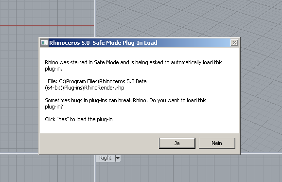

Yes, I installed Windows updates today and reboot. Safe mode works, but I can’t render in safe mode, an error message is shown.
Is there a way to go back to a previous Rhino version? I can’t work on my project and my client ask for some new images now.
Micha, did Rhino stop working with the Windows update, or Rhino update ? I imagine you can load the render plug-in in safe mode- what error message do you get, exactly?

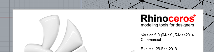

Bug added for the bogus expiration date on the splash screen, but still digging for your real problem.
