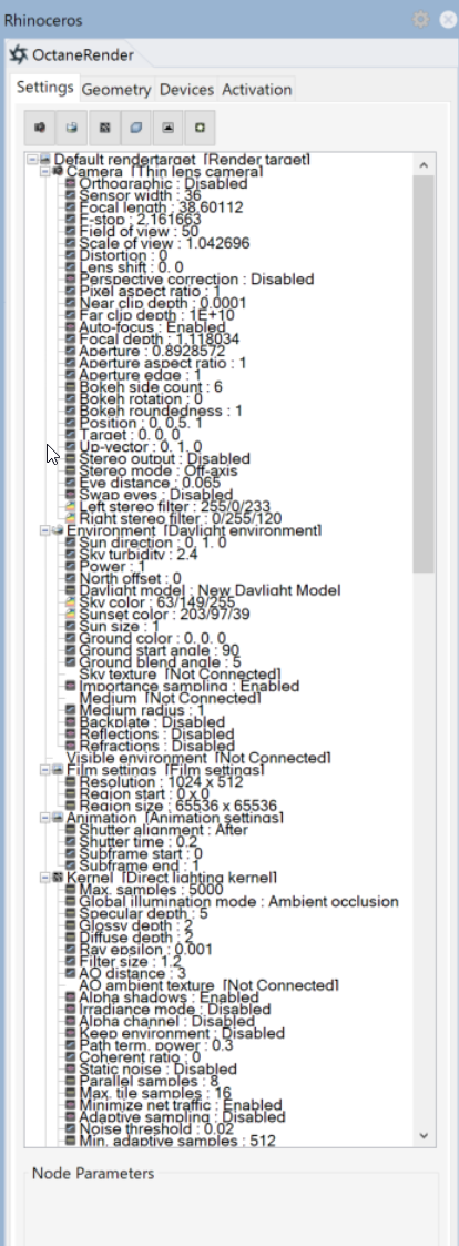

@Nikolay The Octane list are the only UI of Octane. Yes, lists are like .vropt file, but more clean, easier to read for humans, no special syntax is needed, only a table with name and value. I expect something like:
GI
GI saturation 0.5
GI secondary multiplier 0.8
Camera
Tilt vertical 0.2
Tilt horizontal 0.0
Shift vertical 0.2
Shift horizontal 0.0
This options tables could be placed at the global options, at materials and at the object V-Ray properties. There could be found all options which are supported by the core engine but got no place at the UI. For a first run a global option table could nice.
