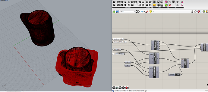

Here’s a definition that cylindrically projects a cage and uses that to morph the geometry
cylinderWrapMorph.gh (69.8 KB)
Good morning Daniel. Thank you for the first test version. I tried out my simple test objects and the outer mesh did try its best to move in and fit the inner cage… but the fit… only met the outer most point and stopped. the mesh didnt… so melt onto the new surface… if you know what I mean.

ps. I looked at the cluster and spotted the Boundary Box function was pulling the mesh towards the internal object based on one outline from one height point… meaning it pulls the geometry towards the face but does not keep going to cover the other deeper surfaces…
Yes - if you can do this it makes the morphing more straightforward.
I shared this example with the cylinder because your file had different vertex counts and topology between the reference and target geometry, and you described moving towards the centre along 1 axis, so I thought this was what you were after.

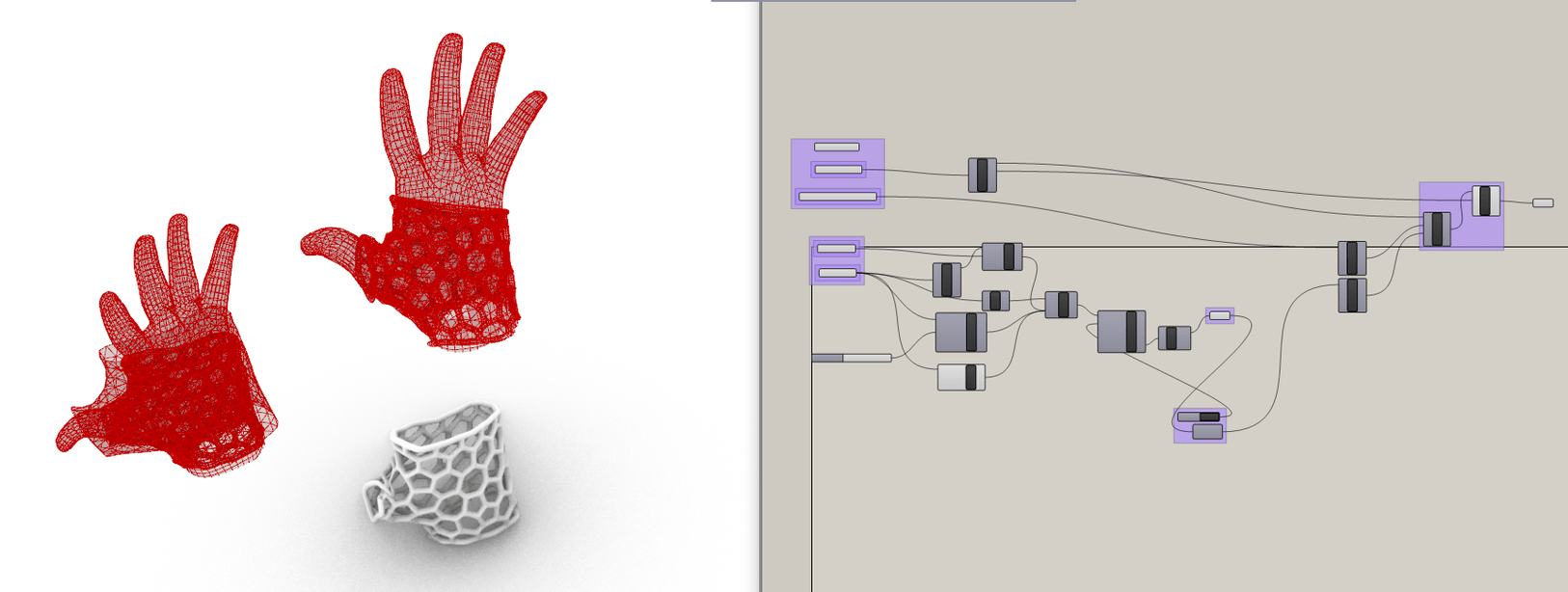

Here is an example of what I do. Why I need this.
Because every hand is a little different but building a new construction every time… with the same wall thickness and same conponents like the holes and belt holders… is a real pain…
So my hope is… using your system… new hand comes in… exisiting design is fitted around new hand… checked and done.
Here is an image of what I mean.
I think in this case it would work best to make a cage with fairly simple topology on a reference hand, and pull the vertices of this cage onto the different target hands.
Then you could model the detailed structure around the reference hand, and morph from that to the target cages.
I’ll try and make an example.
Here’s an example showing wrapping a mesh onto a new target and morphing to that
wrappingmeshes.gh (619.2 KB)

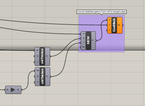

The component with the Play icon is a Data Dam component.
This delays the downstream components from calculating until you click it.
It is needed here because the final morphing can take a second or two, but the wrapping happens iteratively, and we don’t want to have to wait for the morphing each time it updates.
When wrapping onto different hands the ‘LengthFactor’ input might sometimes need adjusting so that it fits well, and it can be helpful to see live updates during this.
So in this definition you need to let the wrapping part run, checking that the mesh labelled ‘cage wrapped onto target hand’ fits well, and adjusting LengthFactor if needed. Once it has finished solving the Kangaroo component will say ‘converged’, then you can click the Play icon of the data dam to pass it to the morphing part.
This is what I’m referring to when I say I’d like to make it simpler - I think there might be a way to automate some more of these steps.
