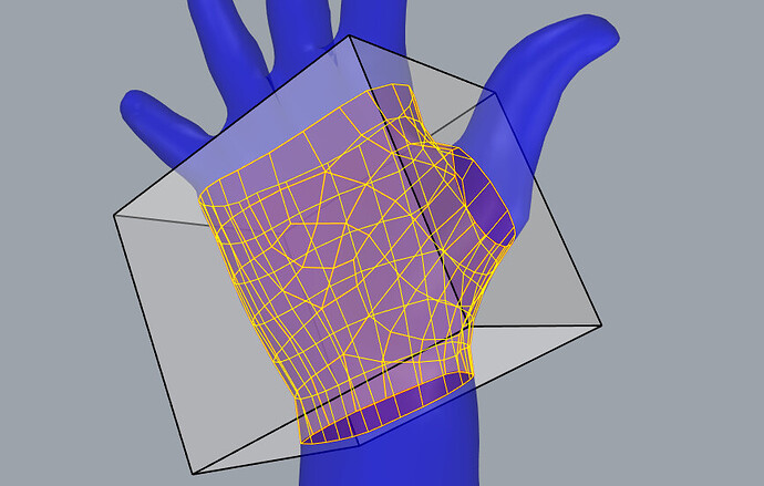

Has he just split the original mesh with some cutting planes and then done a TriRemesh?
I started from a box, extruding and deleting faces, then quadremeshing and pulling onto the reference hand with a similar definition as the other part.
I like the way @martynjhogg describes though and it might actually be easier.
Indeed, using mesh split then remeshing that seems to work well

One little thing I noticed… when you create the first cage… copy that and move it onto the new body… then change the cage a little to fit around the new body… well depending on what you do with the new cage… (changes) you get very off results… crushed up results or just simple weirdness… ( screen shot )
Just so I totally understand…
(1) Make a copy of your original object mesh-
(2) Split the new mesh so it covers where your object will be placed.
(3) Select your original object and also the new cut mesh ( cage ) into the top of the grasshopper system
(4) Copy that cage mesh and move it over the new body ( body 2 )
(5) Edit the new cage to best fit the new body ( body 2)
(6) Add the new cage and new body 2 into the grasshopper script.
Two questions. How best to edit the cage ? so I get a clean transfer ?
Second question. Should I re-quadremesh the original cage and also the second cage, so they both have the same quad count ?
Thank you. Ian :slight_smile:
I think you need to create the cage-mesh (and quad it) just one time
once you have a good cage-mesh, you will use it as:
→ cage n°1 as base-point for the transformation of the HQ mesh
→ a copy af the same cage-mesh (baked in Rhino → reoriented in space in such a way it kind-of covers the new hand → re-referenced back to GH) that goes through the Kangaroo definition and becomes the cage n°2 (final deformation)
so it’s the very same mesh with very same number of point, faces and adges, that gets just stretched around a new hand-model
I have also found useful to add a grab component in Kangaroo and play stretching a little bit the mesh here and there just to avoid those little waves that sometime happen
