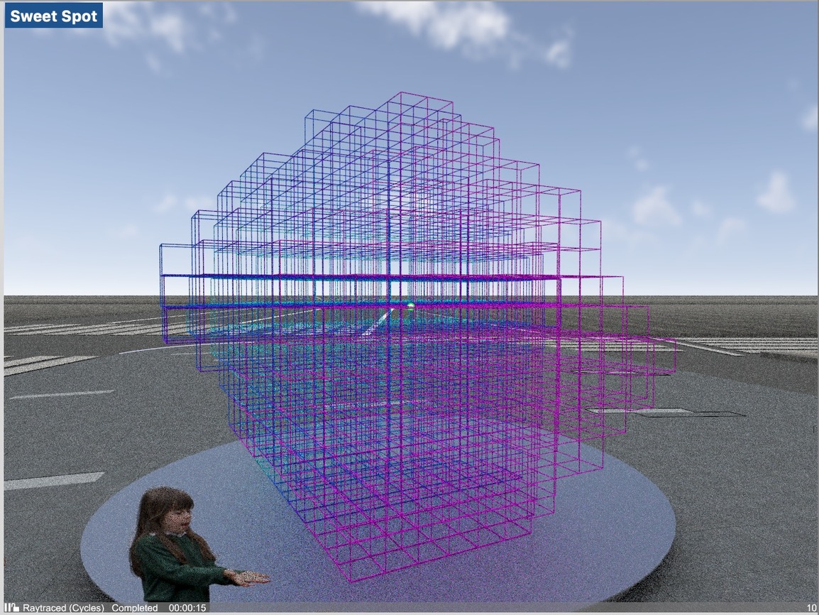

Here’s another comparison at 100 samples to show difference more clearly, viewport is first -
Viewport%20100%20samples
Cycles%20100%20samples
Viewport is brighter, sharper, less noisy. Maybe it’s because shadows are not fully calculated, and this is deceptively seeming like higher quality?
I also noticed when using RecordAnimation that every frame reloads meshes, textures, etc which wastes time - vs viewport where once they are loaded you can update quickly.
Note that in the upper screenshot you see the OpenGL rendering of the scene, not the Raytraced version.
RecordAnimation doesn’t know about Raytraced, best would be if it did, then it could use the viewport for the rendering where it is then just a matter of adjusting the viewport, wait for the samples to be all calculated, then capture.

Can you clarify - you said viewport and renderNext use same engines - but then you said viewport was OpenGL not Raytraced. Or maybe you meant Render (you said “upper screenshot” which was viewport).
Besides that question, what other test can I do to figure out why Render on my machine looks way worse than on yours? I’m using a 2019 MBP, loaded. Will also test on iMac with 3.3Ghz i5 and AMD Radeon R9.
Secondary question - if you use RhinoCycles_ChangeSamples, it seems RenderNext ignores quality settings. Is there a way to control render quality without setting samples manually for both viewport and render each time?
Another thought - since on newer Macs the display resolution is quite high, and uses dpi scaling, a Viewport of the same apparent size as a 640x480 Render output is not in fact the same resolution as . To demonstrate, if you take a screenshot of the viewport of seemingly identical size it’s actually 4 times the resolution (1280x960). When you first open it in Preview it looks to be the same resolution at 100% - but that’s because it’s 144dpi instead of 72, and the Mac OS interprets 100% “actual size” as apparent size, NOT actual resolution. (Which is annoying on many levels.)
So my theory is the Viewport of the same apparent size is actually much higher res. Therefore it looks better. And also explains its much slower rendering time (6 minutes vs 1 minute).
They use indeed the same engine. When I say you see the OpenGL bit it is the ‘preview’ of the scene before Raytraced manages to put any of its own results on screen.
Hmm, it should use the sample count that has been set with RhinoCycles_ChangeSamples. Or what quality setting are you referring to?
This may very well be the case. Just for the record can you please go to RhinoBETA > Preferences > Advanced and type DpiScale in the search field. What does the value for RhinoCycles.DpiScale say?
Other than that Raytraced (and Rhino Render Next) is rendering at the resolutions it is told to by Rhino. So if there is a descrepancy between the two that needs to be fixed.
