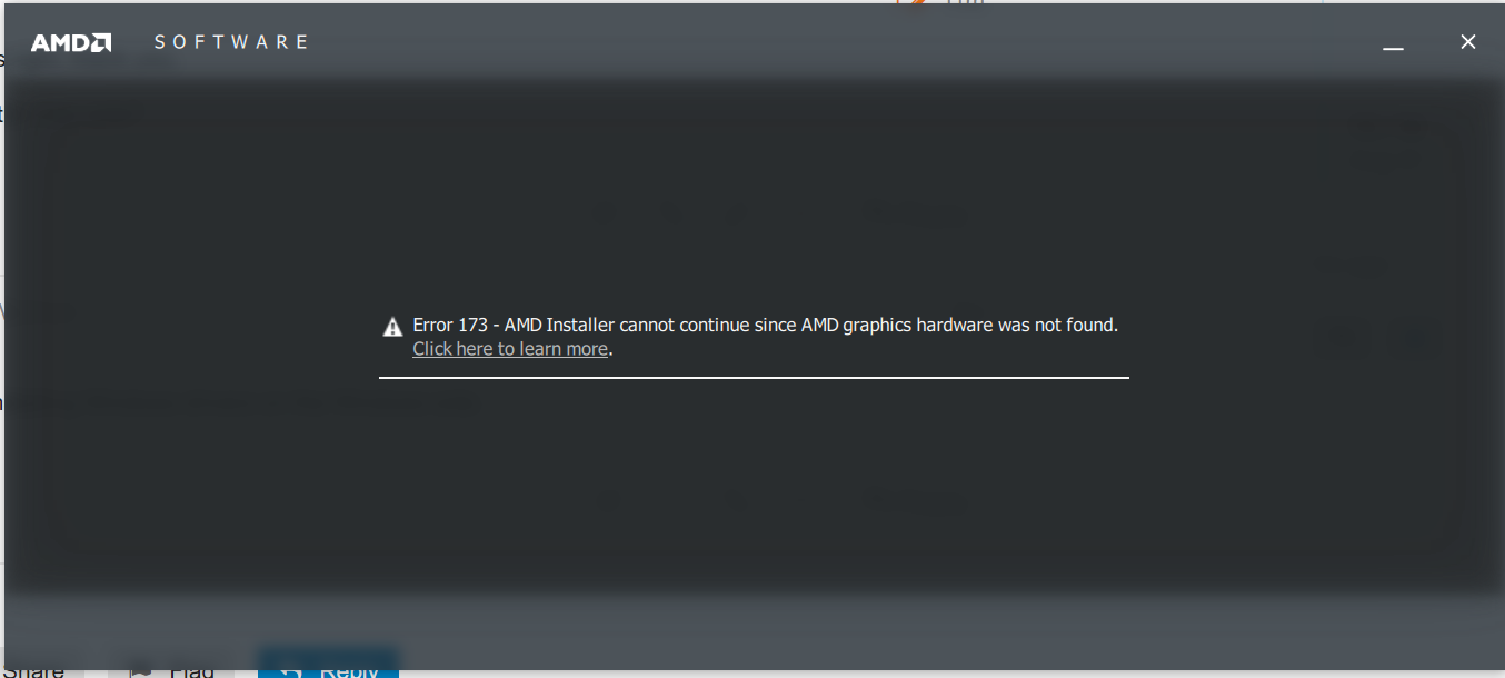

I am having trouble with my raster output option for printing, the window remains black and even after I press print the image remains all black. I have my settings on default and I am not sure how to fix the issue

From that information it looks like there isn’t any GPU in your machine and that Windows has to do all the drawing. This is rather unlikely. Please find out which GPU model you have and install an updated driver for it.
I don’t know if it is good to mention that I use a Boot camped Mac
Hello - you’ll need a driver for your video card - you’ll need to sort that out first, I would say.
Thank you for making me aware of this, you are right it doesn’t look like I have a graphic driver installed
Any suggestions? I am not knowledgeable about proper graphic drivers, I only use this laptop for school so I don’t need anything over the top or taking high quantities of space
Hello - you’ll need to determine what the graphics support is on this machine - that might only be possible at this point on the mac side, in system information. Once you know what the card is, you can go to the manufacturer’s website and get the appropriate Windows drivers.
Save the attached .zip file to your desktop…Double-click the .zip file to open it up…and then move the DeviceID.exe file to your desktop as well.
Once you have the .exe file available, double-click it to run it… Answer “yes” or “allow” to any dialogs or warnings that might popup… Then just take a screenshot of the application running.
Since it appears there is no driver installed, make sure the “Driver summary” checkbox is NOT checked…by default it should be unchecked…so just run the application, screenshot it, and then post it here.

The app thinks there’s an AMD “vendor” somewhere, and yet none of the other information indicates an AMD device.
The DeviceID of 6821 for AMD is the “AMD Radeon R9 M370X” found in 2016 MacBook Pros… Does that at least sound right?
I would go here:
And expand the Windows 10 64bit Edition and download the 8/27/2018 drivers and see if they install.
-J
Yes, that sounds right, thank you,
do I install it on the mac side?
No.
Jeff described installing Windows drivers on the Windows side.
Ya, that was somewhat expected…that’s why I said “see if they install” … I’m still looking into this…I’m tweaking the DisplayID app right now to show me more information…give me a few…

You might try the Bootcamp drivers from AMD… I was just trying to find you specific display drivers, based on a device ID…obviously that didn’t work.
https://support.amd.com/en-us/download/desktop/bootcamp
-J
My college from two years ago installed the Boot camp, I just recently opened the windows side again and updated everything.
